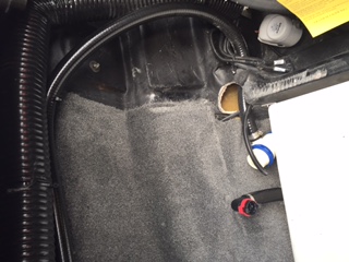

File comment: The hose goes up to this anti syphin loop located on the back side of the rear seat cushion in the engine compartment.

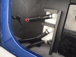

Here's more of the ballast set up
File comment: After the loop it comes around and down to fill the stock hard tank. It's fills through the middle connection. The far right is what attaches to the front of the PNP bag to fill and drain the bag. The far left is a small vent line for the hard tank that goes straight out a through hull fitting.

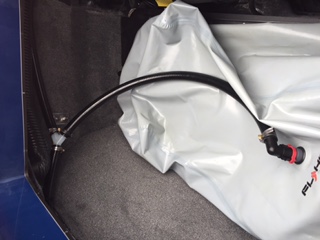

Here's what the rear looks like. The drain pump on the right. And the left hose goes to the rear of the PNP bag to fill and drain the bag.

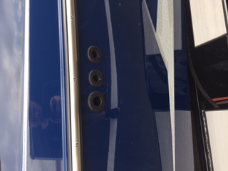

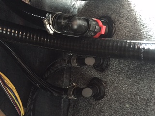

Here's the thru hull fittings. Looking from outside the boat the rear most port is the drain. The middle is a vent for the stock hard tank. And the furthest forward to the right is the bilge
File comment: Here's the thru hull fittings on the starboard side. This is taken while lying on my back looking up at it. The far right is the drain. Middle is the vent for the stock hard tank. And far left is the bilge.

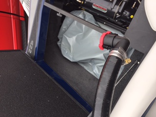

Use marine silicone and a hose clamp to attach the elbow to what is going to be new vent hose.

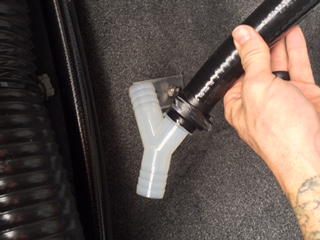

Posts: 24

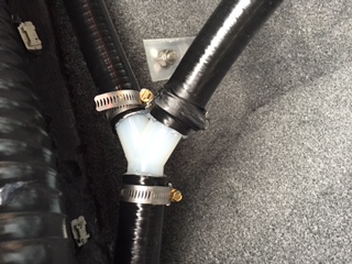

Measure out how much hose you will need and cut it with a pvc pipe cutter. Then attach a Wye. This one was bought from board stop. Use silicone and hose clamps. It's also a good idea to wrap all clamps with electrical tape so that they don't puncture the bag.
 Post subject: Re: 2016 PNP write up and adding vents
PostPosted: Tue Mar 29, 2016 1:14 pm
I'd also wrap the hose clamp with electrical tape to prevent accidental puncture or scrapes/cuts to your hands later on.

Cut into the drain and attach he Wye in the same way that you did before.
