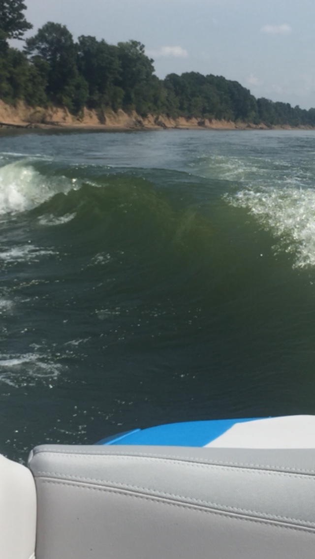

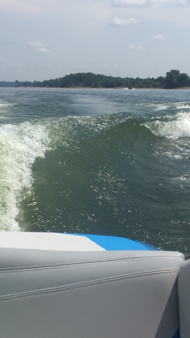

Here are a couple without the extra and no wedge for skin.

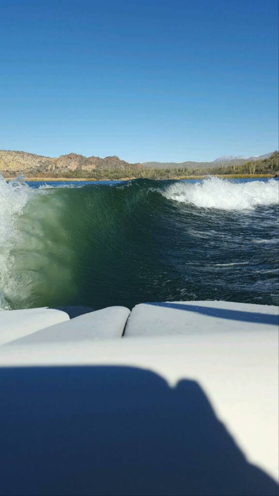

Posts: 480
I don't know much about surf setups yet because I still wakeboard 100% of the time but what do you guys think of this wave? 2016 A20, stock 800 lbs ballast plus the T-Series P&P bow bag and P&P 550's in the rear.

Looks Good. The New A20 is very impressive. It looks very long and clean. The wave does look to be very steep with less wrap compared to the larger boats but if you where to surf a lot you would add more ballast which would help also.
