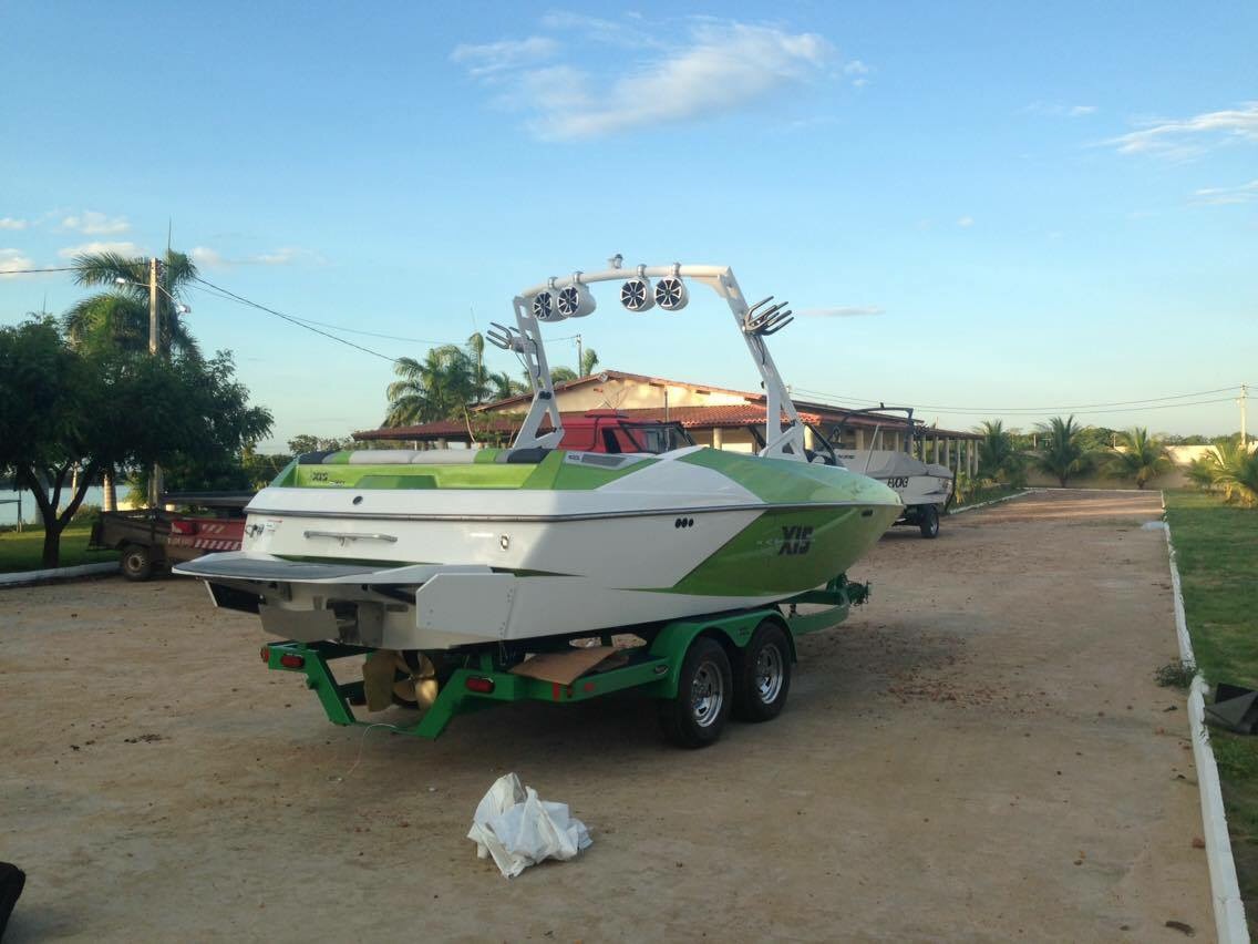

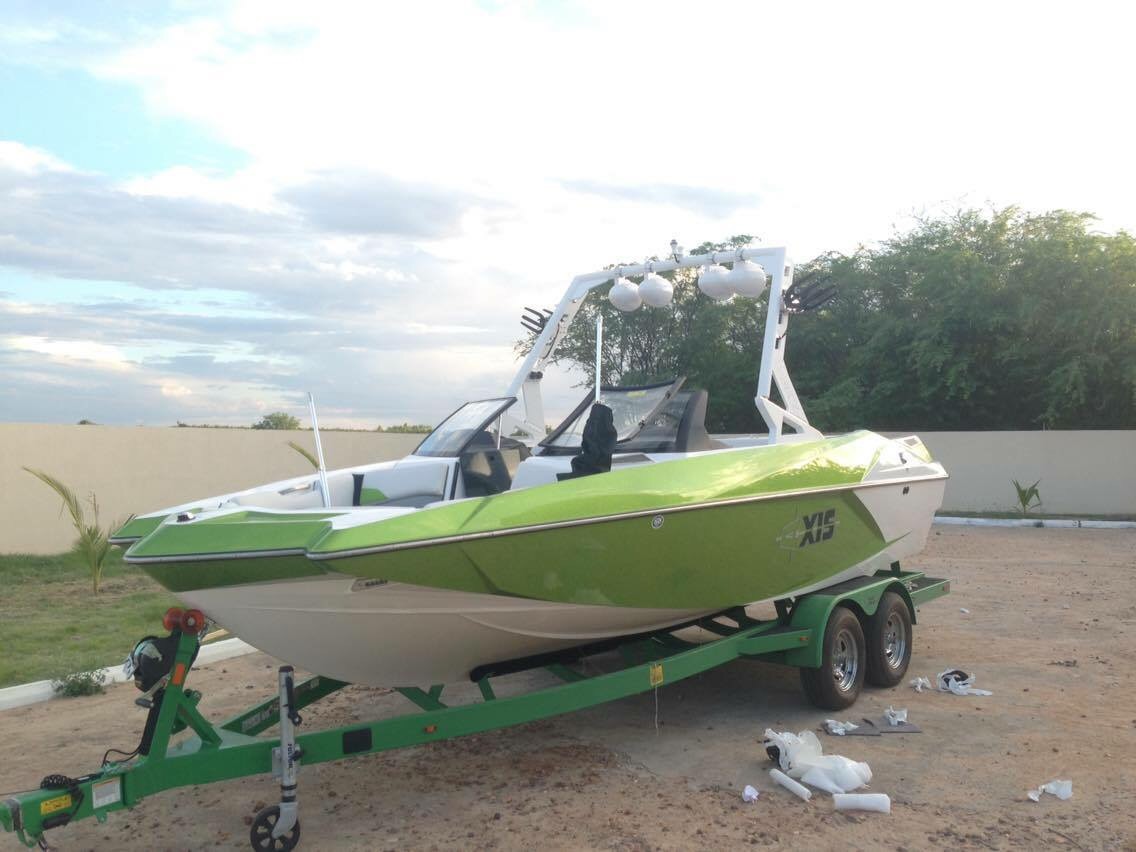

In fact the boat I'm evaluating to buy is from the end of 2014 and has the redesigned hull. Do you happen to know it has already the tractor gear ratio? Or only the ones made in 2015?
I've attached a pic.
All the best

do you have access to the build sheet or serial off of the drive? with the newer tower, wetsounds sp2 etc. its a 2015 so probably has the newer ratio
 Post subject: Re: A22 2014 with moonson 350 need to decide
PostPosted: Sat Dec 26, 2015 8:49 am
That's definitely a 2015 year model A22 hull and tower. The 2015 boats started to be built in July or August of 2014. The fact that you said you were looking at the boat at the end of 2014 probably means the dealer already had it delivered so it's a 2015. Do you have access to the VIN number of the boat? Also, see if you can find out the prop model. The 4 digit model number is stamped onto the center hub of the prop if you are not familiar with that. Kind of odd they went with the green trailer instead of white. The green is the flat green that doesn't match the metal flake green. Dealers usually get the trailers to match the base hull color which is white in this case. Bad error on their part but the boat is beautiful. My friends have the same colors on their T23 and looks great in the sun.

Many tks. He told me the propeller is the hi torque but he doesn't have the reference.....so the tractor w the new gear ratio is strong enough to get it out the hole? Many thanks for all the explanation . Odd this trailer color.
