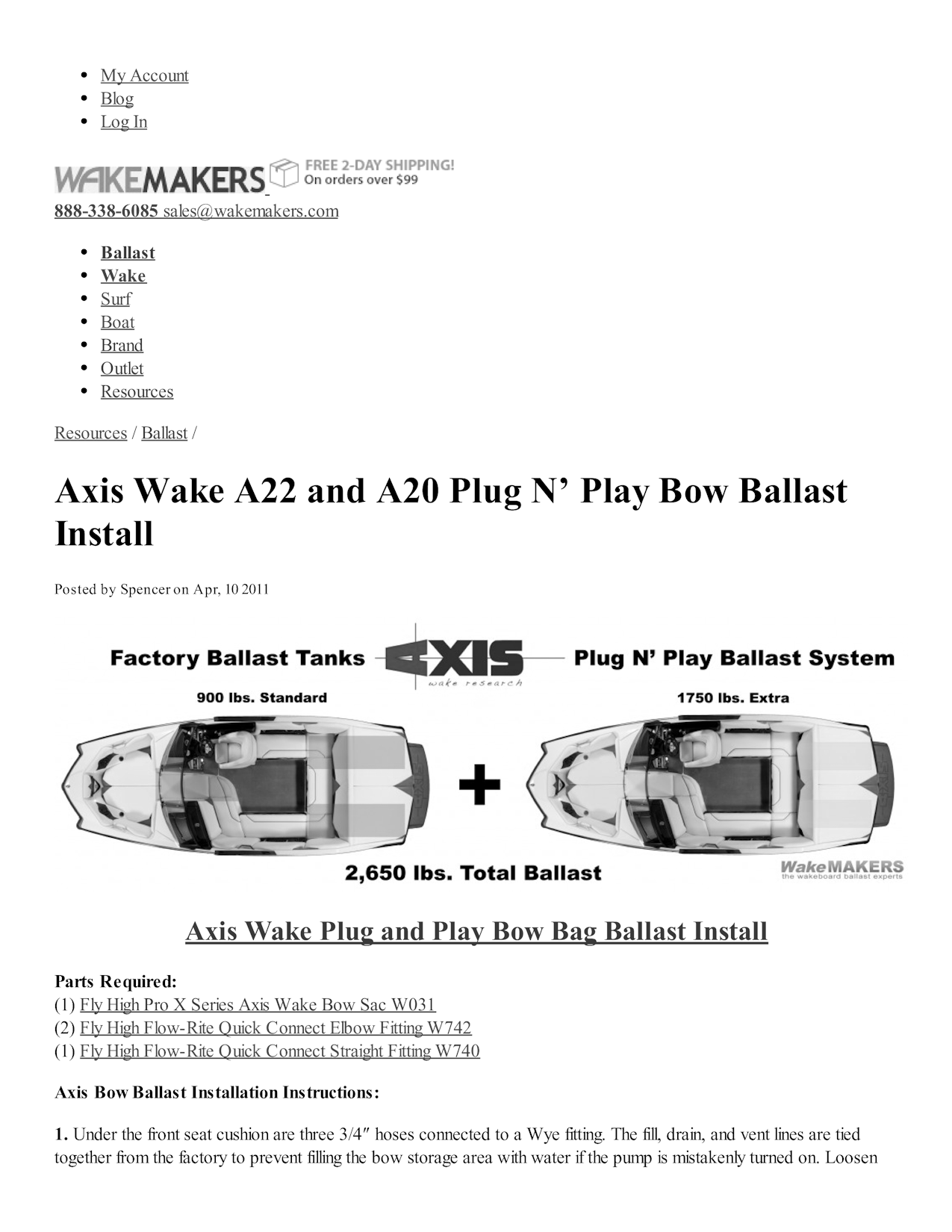

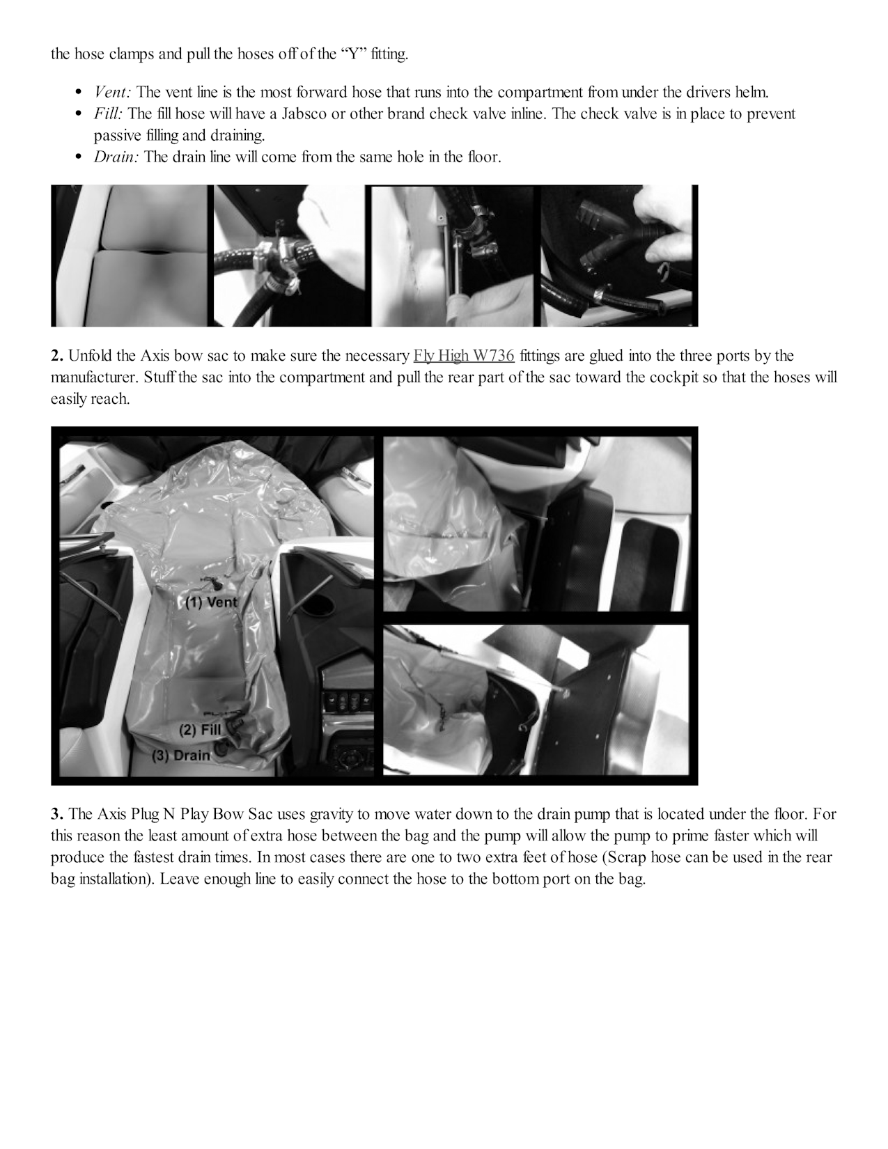

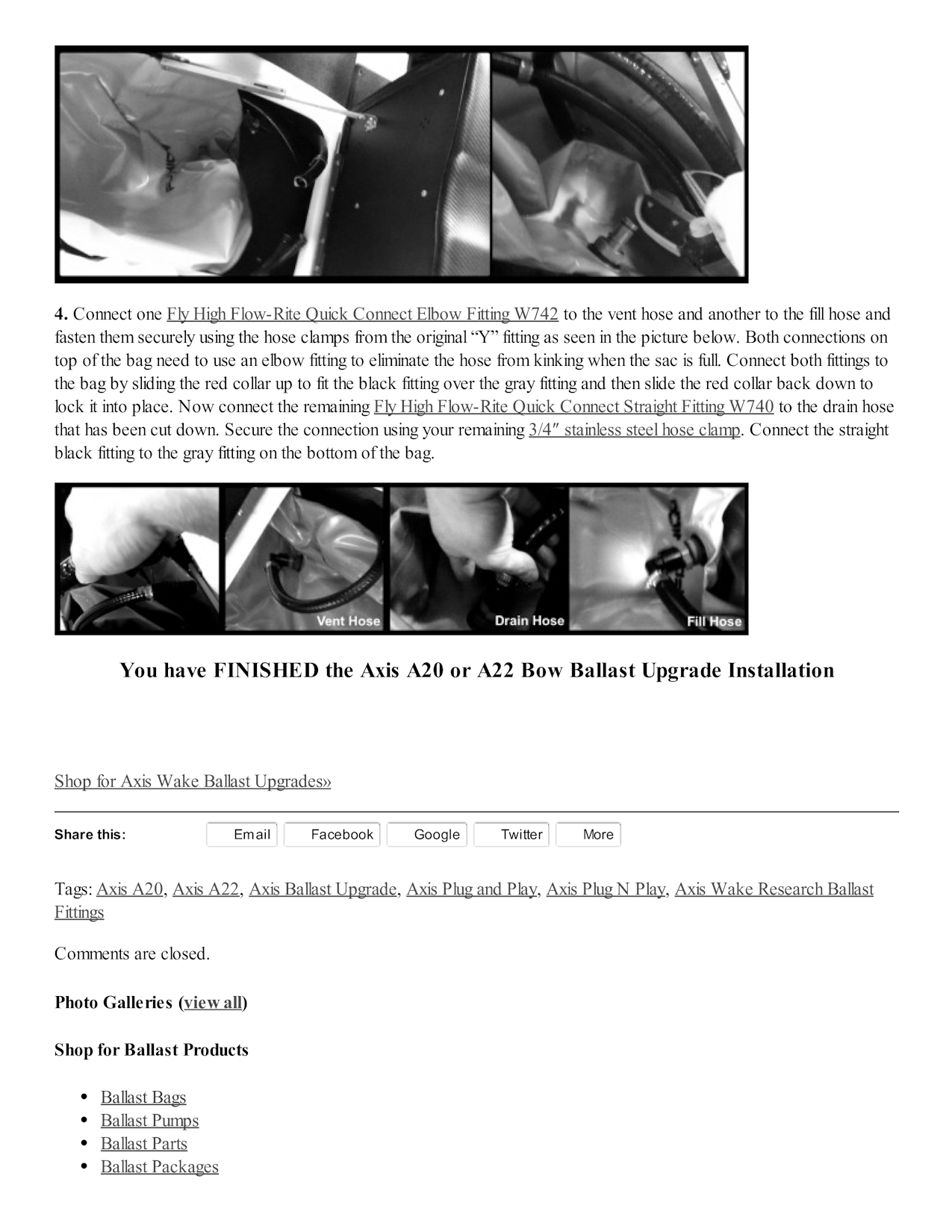

Have a read
Axis Wake A22 and A20 Plug N’ Play Bow Ballast Install _ Resources1.1.png [ 233.03 KiB | Viewed 23194 times ]
Axis Wake A22 and A20 Plug N’ Play Bow Ballast Install _ Resources 2.1.png [ 379.08 KiB | Viewed 23194 times ]
Axis Wake A22 and A20 Plug N’ Play Bow Ballast Install _ Resources 3.1.png [ 331.75 KiB | Viewed 23194 times ]

thanks but its not like on 2015 boats, no Y ???

Sorry, I thought they would be the same. I copied and pasted this from a post where they were installing a bow sack in a 15 A22
"On my A22 (same bow as A24), I had two drains lines on each side closest to helm and then the line that circled around needed to be disconnected from the barrell fitting at the passenger front side. If I remember correctly the hose going under the driver helm was the vent. I guess they connect the vent and fill in case someone flips the switch without a bag installed. Hope this helps."
Hope that helps.
