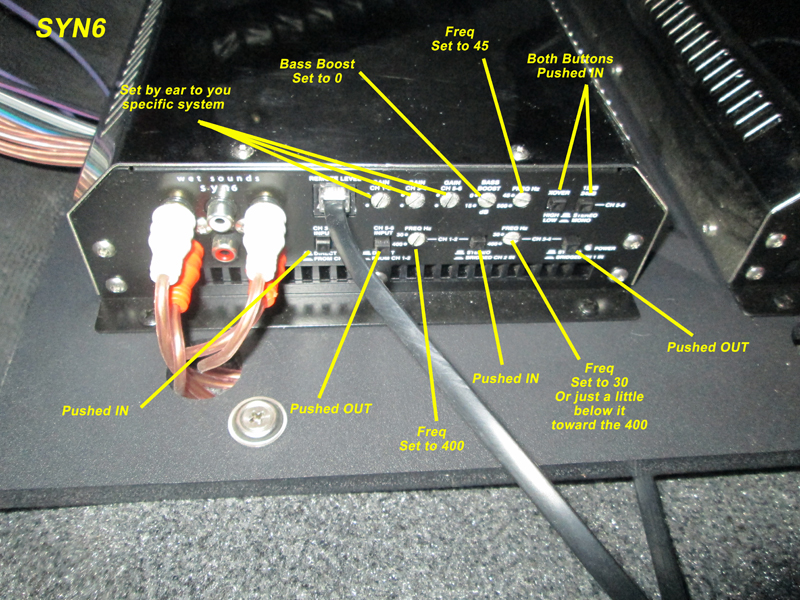

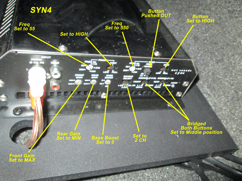

Anyone that has sound pack 3, Can you post up a picture of your amp settings? I had a 3 year old climb in the storage under the glove box and mess up all the dials and buttons on my syn 4 and syn 6. Much appreciation to anyone who can help me figure out where they were set before. Thanks in advance!

i would but the boat is 1.5 hours from us. We will be going this weekend and I hoped to show up with a decent idea of what to set. So, if anyone has their boat handy, snap a few pictures for me. I'd be most appreciative!

I have SP3 and this is how mine is set up.
Hope this helps.

Bama, that is exactly what I was hoping for. Thanks so much! Love this forum!!

Keep in mind these are analog components so the best settings are going to vary from one system to the next. You can use Bama's settings to get close but best thing to do is follow the tuning procedure from the wetsounds website.
