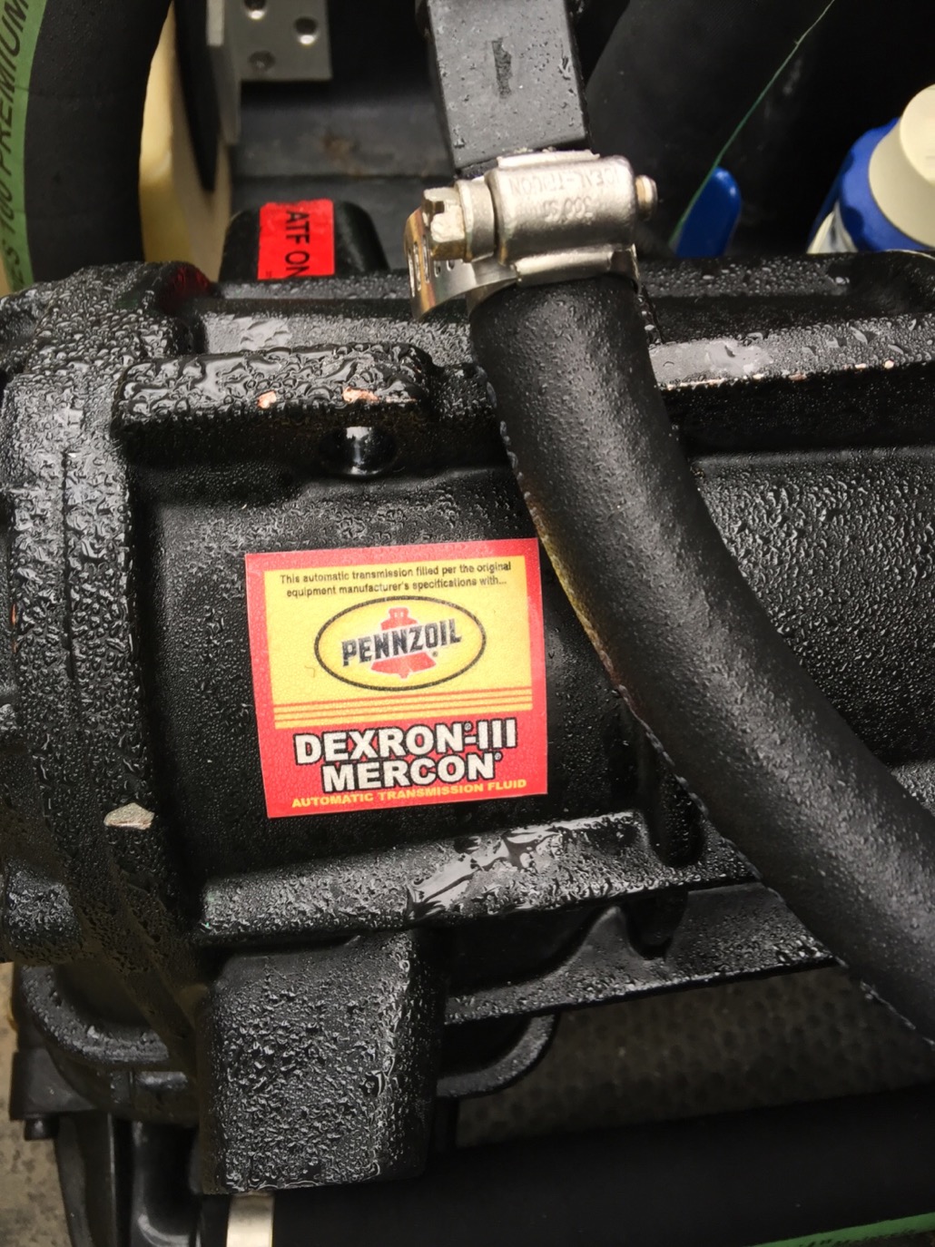

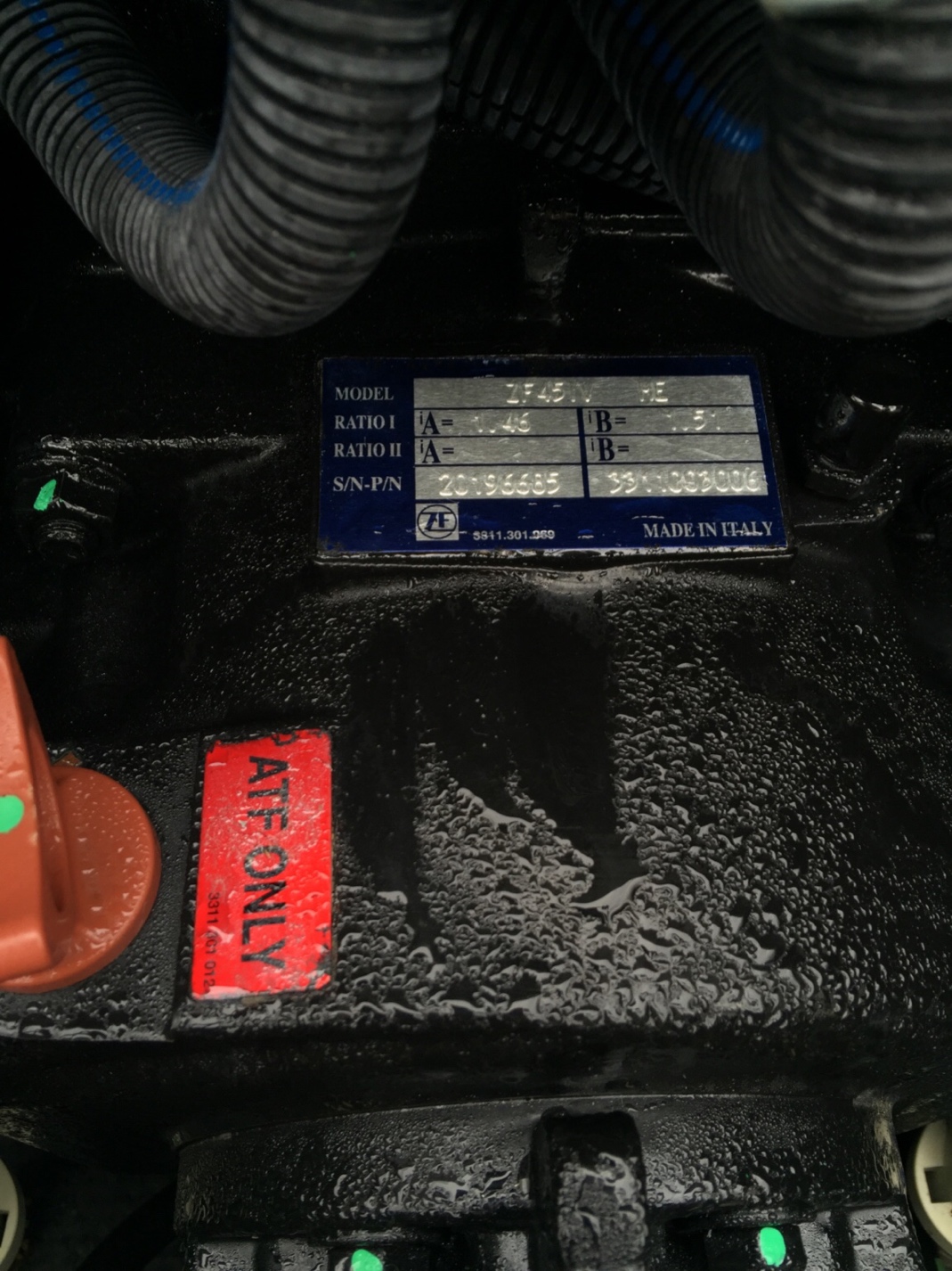

Hey man just to clear it up, I keep seeing some people differentiate between the transmission and the v-drive. Transmission is for shifting, and v-drive is the gearing itself right?
Basically what I'm wanting to double check is if I hit both of these dipsticks seen below on my ZF45IV with the appropriate amount of Dexron III Mercon, I'm covered for the v-drive/transmission? Or is there a hidden gearbox somewhere that I'm not seeing lol.

PostPosted: Mon Sep 28, 2015 6:59 pm
Joined: Sun Oct 05, 2014 6:28 pm
Posts: 60
Location: Arkansas
Siphon from the locations above and refill to specs. As far as the differences in the vdrive and trans, I'd rather let someone who knows more answer that. I'm not a professional but with the help of this forum, the Malibu crew, and the manual a guy can find his way around in a short amount of time.
