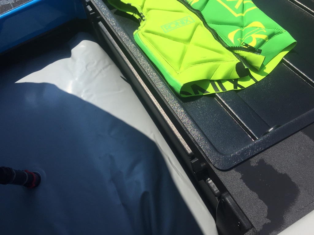

 Post subject: Re: 1100 Rear Bags
PostPosted: Tue Sep 01, 2015 6:13 pm
Mine is reinforced but has some flex still.
PostPosted: Tue Sep 01, 2015 6:42 pm
Posts: 36
Location: SlapOut, AL
Gibbs,
I'm just about done with my mod. I'm using 3/4 treated plywood for mine. Put a aluminum 1/2" "L" shape on the floor right up against the weak existing wall. I used short screws to hold it in the floor. I also put a piece on the back section where your bag connects, up against the weak made wall. I wrapped my plywood (on one side) with a black shipping blanket for now. I will put some poly batting and marine grade vinyl, latter on. Fabric.com seems to have some good prices and u really don't need that much material. I ran the plywood up to the top, allowing the top door to close. I used 1 1/8" deck screws, pre-drilled 3-holes on the top and bottom. The screws barely came through on the bottom, but we're fine on top. We tested it (one of them) on Sunday, no movement at all. I'm sure I could got away with regular plywood instead of treated, once i wrap it, but the weight will not matter in the rear end anyways. Plus I'm only wrapping the bag side, the other side will be up against the weak existing wall.
PostPosted: Tue Sep 01, 2015 8:12 pm
Posts: 1181
Location: Sammamish WA
I just bought some 1" x 1/2 steel [ from the local metal place... Mounted them vertically on the engine side and riveted them on with SS rivets. Looks OEM and hold without a problem!
PostPosted: Tue Sep 01, 2015 9:04 pm
Joined: Sun Jul 27, 2014 11:06 pm
Posts: 38
I just bought the metal bars from Wake Makers. They were pretty cheap and work really well
PostPosted: Wed Sep 02, 2015 10:49 am
Posts: 1181
You will also want to reinforce the C channel that the divider sits in as it will turn allowing the divider to pop out. I used 2 small pieces of angle iron to support it and they work great.
