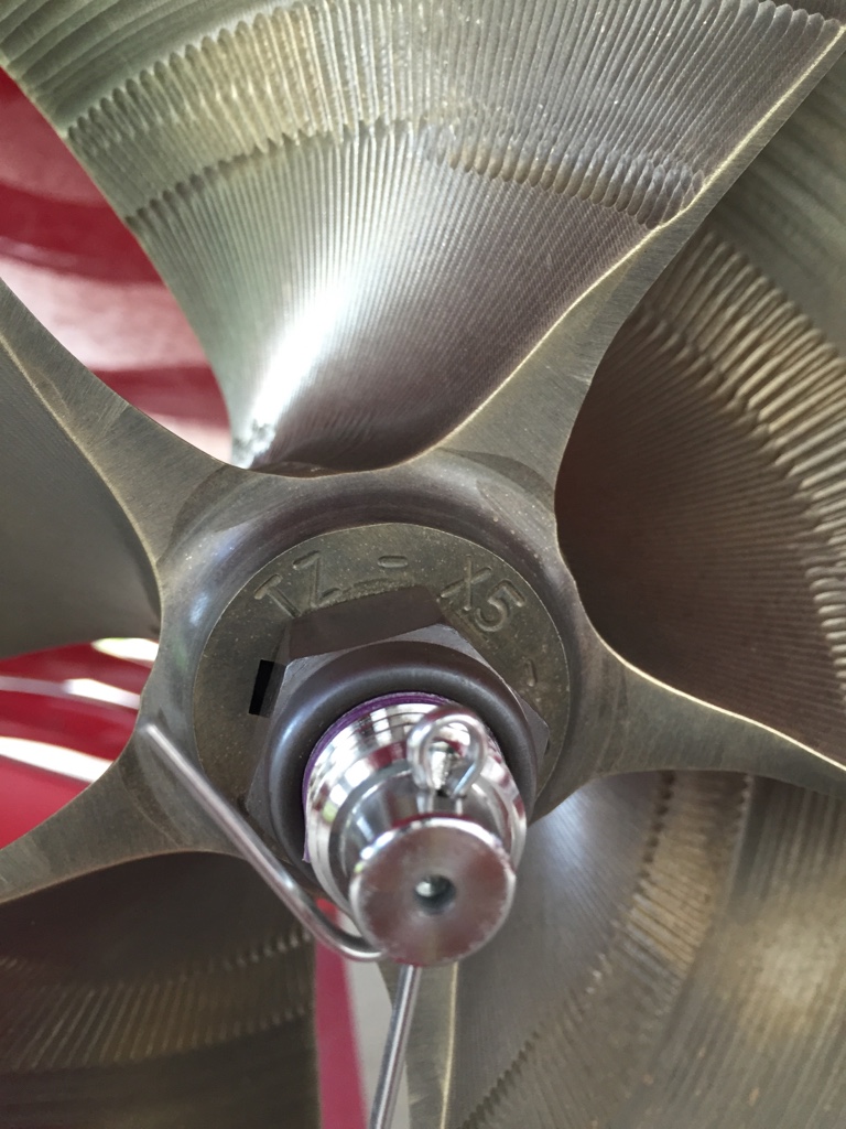

Been trying to read and figure out what prop to buy, and I think I just confused myself. I'm running a 2013 a22 with the 350hp. 900# in each rear locker, 950 bow bag and all factory ballast. Most of the time we have 4-6 ppl. And no wedge. Currently running a 5 blade tz x5. But it struggles to plane when fully loaded with 7-8 ppl in the boat. What prop do I need as I damaged mine this weekend? Thanks

I went from that OJ prop to a 2315. Some good info on this thread - http://www.wakeboatowners.com/viewtopic ... 8&start=50. I boat mostly around 400' but spend a month around 3400' and the 2315 has been great. It's definitely been an improvement.

I'd say if you're currently struggling with that prop to try the 2315, big step up from the OJ5

2315 for me 2013 A22 330 750 rears, 600lbs lead midship, 950 bow.

My buddy runs the 1235 on his '13 with 750lbs rear sacks and the wedge down, arrow full and it gets on plane. He also has the same engine. You should be able to get there with the 2315 or OJ945. The wake will be pimp. Throw a 400lb bag in the nose to make it even better.

I just put a OJ945 on my boat and WOW, the difference is amazing coming from a 1235!
