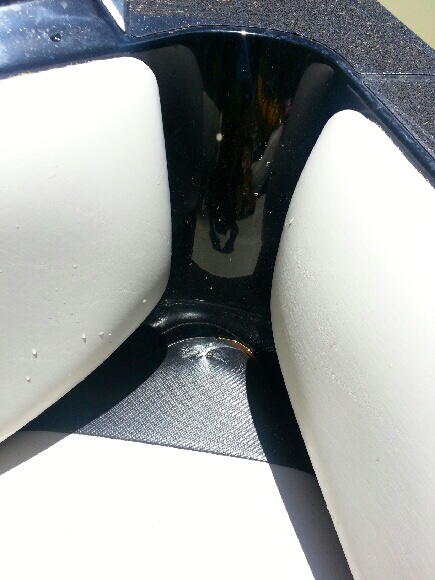

Does anyone have a picture of the area that needs to be covered? Just curious if I'm picturing the spot you are talking about.

This is the spot in mine, was in each corner of bow, Malibu re did the seats under warranty, my choice I asked them to do them in white, and have since had the axis logo deck trak cover supplied my Malibu also under warranty.

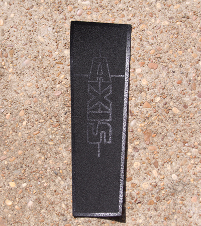

Exactly what is happening. The only fix they offered was a black Axis decal to put in the corner to break up the sun beam.

The deck-trac isn't bad on a black boat but an eye soar in my opinion. I choose to just use a towel but have considered ordering a small sheet of Agenda traction. It comes in lots of colors and a few patters. Plus it doesn't look like industrial safety tape like the Axis stuff does
