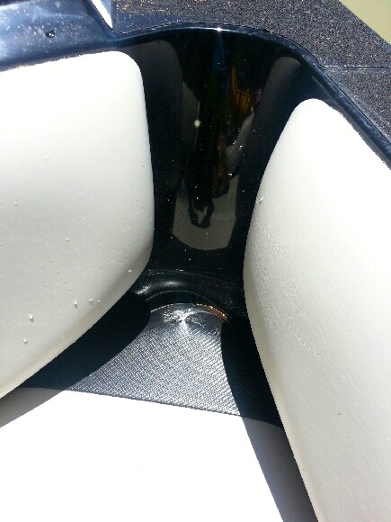

This is the spot in mine, was in each corner of bow, Malibu re did the seats under warranty, my choice I asked them to do them in white, and have since had the axis logo deck trak cover supplied my Malibu also under warranty.

yup x2. My 2011 did it right away, i have a white boat and my cushions in both corners are black, also my front cushion did it too. I worked with the local dealer mechanic and we figured out what it was. Malibu said the reason was the black cushions, we told them they were wrong but they said they would reupholster my cushions, but go white or grey in those areas so it "would not happen again"... well I knew it would happen again but I decided to let them try. My cushions came back and they were exactly the same color, black in the corners. We told them they screwed up and they told my dealer to just give them to me and use them and if they did it again, they will make it right.
Well first trip out, first hour in really hot (100+) weather, they all melted again. My dealer had to put a brand new boat out in the sun, and video recorded the cushions burning/melting, sent that to malibu, and they came up with the deck track pieces to install in the corners.
I was taken care of, had my cushions replaced, and I installed the deck track in a couple minutes...

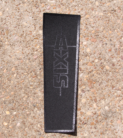

[quote="AJWest"]I guess the Malibu/Axis engineers didn't think the curved gel coat would act like a magnifying
glass and burn/melt the vinyl.
quote]
Exactly what is happening. The only fix they offered was a black Axis decal to put in the corner to break up the sun beam.
