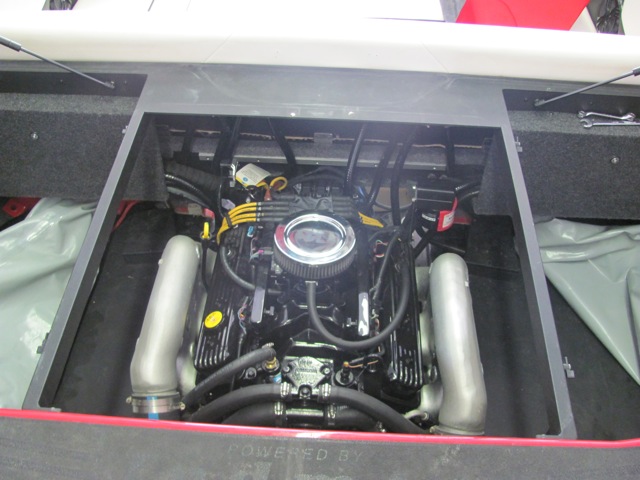

File comment: This is the standard Indmar 5.7 335hp that Axis uses in freshwater boats, the 400hp engine will be identical in looks and will winterize the same too
File comment: Remove the 2 side panels to gain access to the sides of the engine

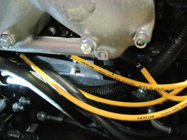

File comment: At the top of the oil pan rail in the center of the engine you will see one brass 1/4 inch pipe thread plug, use a 9/16 wrench or socket and remove the plugs from each side of the engine

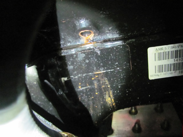

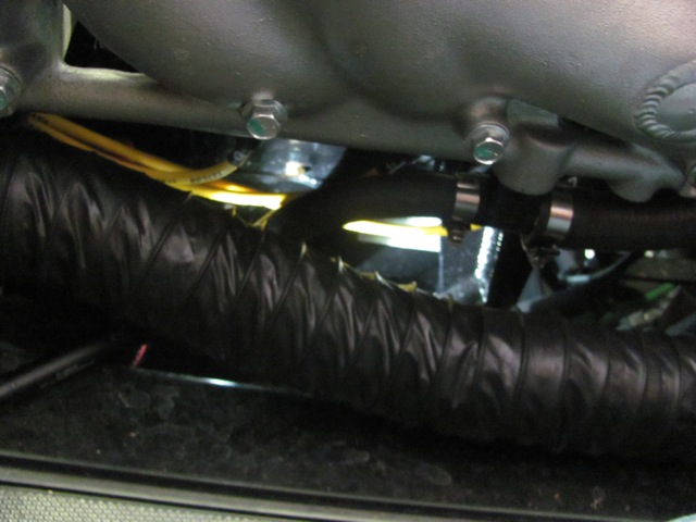

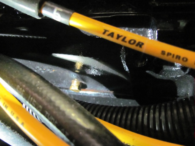

these are the most important plugs to remove by far, if you dont drain the engine block and have a freeze you can usually count on needing a new engine block, and they don't come cheap, The water in there will freeze and crack your cylinder liners, do not skip any steps, do them in any order but just make sure to do them. Be sure to remove the plug on both sides of the engine, one does not drain both sides, the water jackets will hold nearly a gallon individually per side

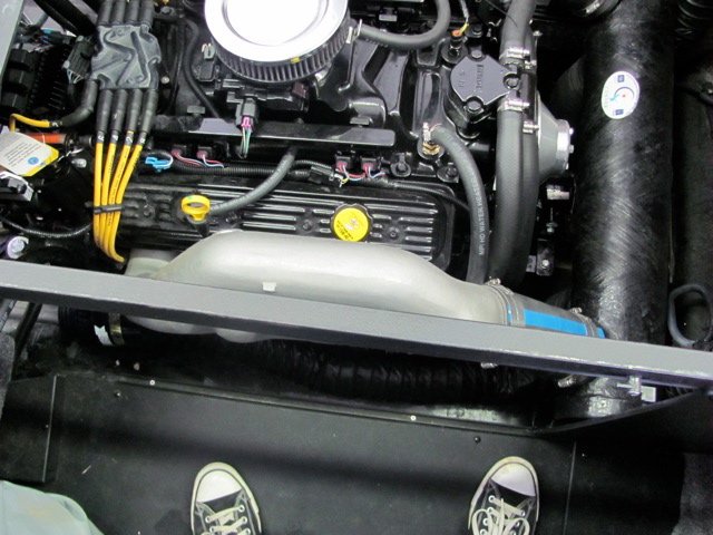

File comment: The passenger side may be a bit harder to see due to the blower hose being right below the exhaust but use a flashlight and you will see it easily

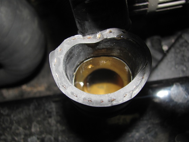

File comment: This is with the plug removed and all water drained, usually about 1 to 1.5 gallons will come out, if you remove the plug and nothing comes out you may have sediment covering the hole, if this happens use a small flathead screwdriver and gently push it into the hole and use a twisting motion to break the dirt loose while pushing up toward the cylinder head, this is only to be done on the gen 1 small block chevy engine used in all 09-11 Axis boats, the LS3 and big block engines have blind holes and draining them will be different.

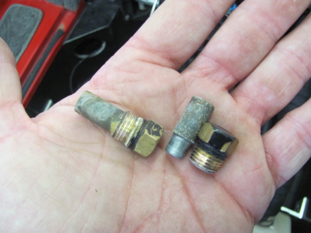

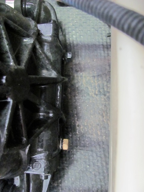

File comment: Next remove the transmission cover and locate the 2 brass plugs on the rear of the v-drive, when reinstalling them DO NOT use any sealant or anything on the threads, these are sacrificial anodes and must be able to conduct electricity to do their job correctly

File comment: These are the sacrificial anodes in the v-drive, they should be replaced if they are over 50% corroded, better these than the engine block if you ask me

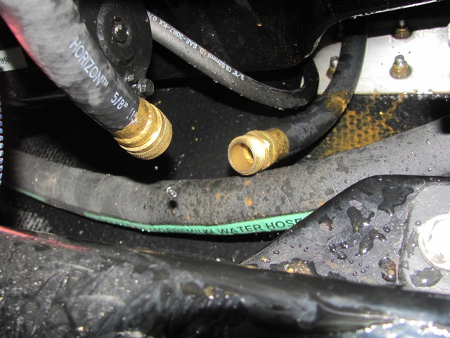

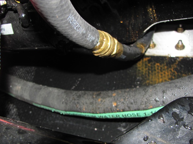

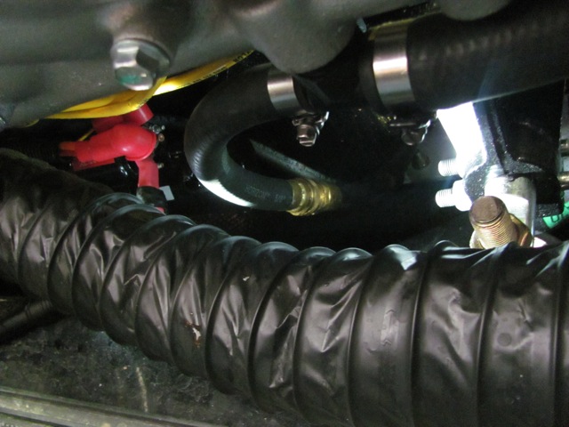

File comment: next look below the exhaust manifolds, there should be a 5/8 hose connecting the two sides together that loops under the oil pan and has a water hose connector on it, unscrew it and let all the water drain out of the exhaust
File comment: unscrew this hose just like you would a water hose

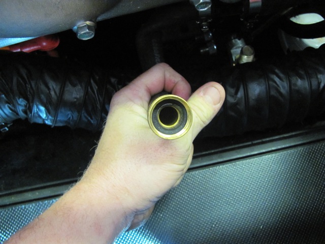

File comment: be sure when you put this back together that the seal is in there, if you lose it just pick one up for a water hose at your closest hardware store

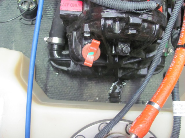

File comment: On the driver side locate the transmission cooler just above the alternator and below the exhaust manifold outlet

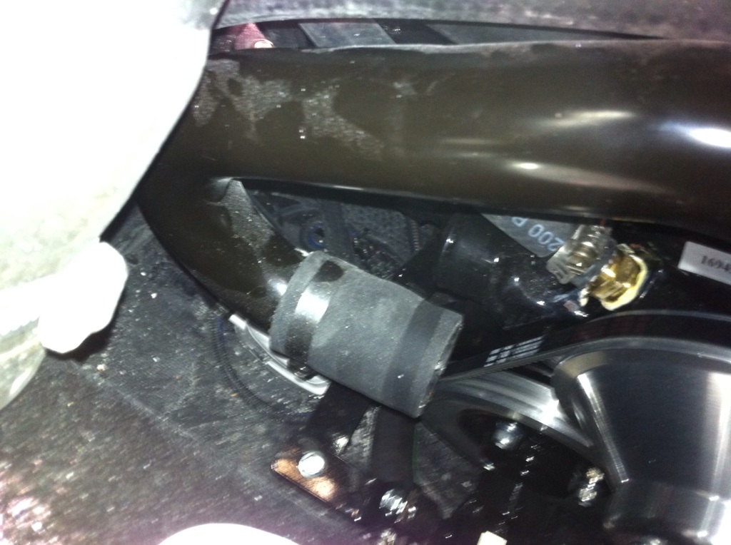

File comment: loosen the hose clamp and remove the lower hose on this cooler, this hose is the main water inlet to the engine coming from the sea water pump and it will hold water in it that can freeze and damage the cooler, push the hose down toward the floor to get all of the water out of the hose

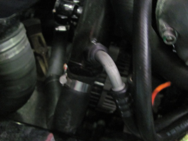

File comment: look for the J hose going from the thermostat housing to the water pump, disconnect this hose at the water pump

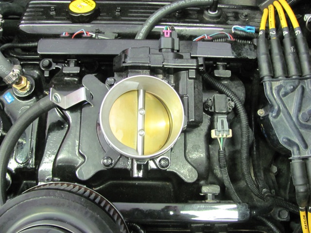

File comment: remove the air filter and unplug the ignition coil, have someone crank the engine for about ten seconds and spray the fogging oil into the throttle body, button everything back up and your done

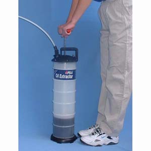

this is the oil change pump that I have
http://www.wholesalemarine.com/p/PEL-PL ... acity.html
this one shows to list for 99$ but I found mine local for probably half that
they are really clean and easy to use, you will need a container to put the used oil in to dispose of, sone places will take it at no charge, I do, we have shop heaters that use waste oil instead of gas, very efficient heat source
