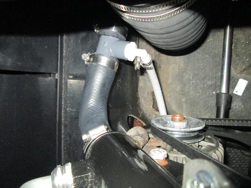

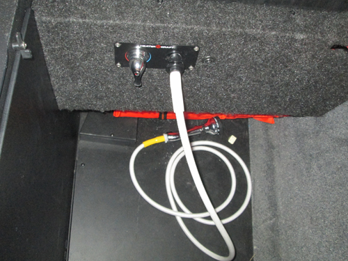

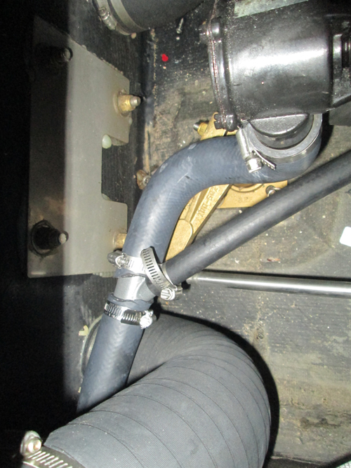

 Post subject: Re: Hot Water Shower Kit
PostPosted: Tue Dec 16, 2014 10:33 am
Hope this helps. Can get more this weekend if you want me too.
