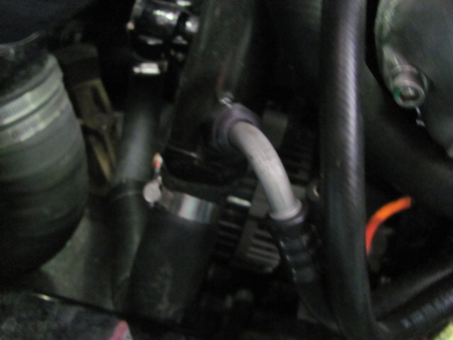

Something strange is going on with what I believe is the alternator in some capacity. I will be driving the boat (towing, cruising, etc) and the voltage on the dash will drop to as low as 11.8, and hang there for several minutes. At some point I will hear pretty bad belt screech and eventually (10 seconds or so) it will stop and when that happens, the voltage goes back up to 14 and stays there. If I go a week or 2 without going back out on the water, the process repeats itself. If I use it daily, it tends to hang at 14 volts the whole time.
Is it just a bad belt? Failing alternator? I wonder if maybe the bolt threads are stripped or something?
Is the alternator easy to see or get at? I'm driving a 2011 A20 with the standard Indmar engine, I think 335. Any manual I can pull up for some guidance?
2011 A20
 Post subject: Re: Voltage problem - varies drastically under operation
PostPosted: Mon Dec 08, 2014 10:34 pm
It's behind the driver side panel just below the trans cooler

Ok so I was able to get a look/listen at it. The screeching is definitely there around the 2k rpm range, but it's very faint. Whenever it fixes itself it gets much louder and then stops (though I couldn't make that happen today). Anyway, I let the boat sit there at 2k rpms for a bit and watched my voltage drop from 11.6 down to 10.0 over about 3 or 4 minutes.
I can call my local dealer for the part...but how hard is it to replace the alternator? From what I can tell it's held in place by 3 bolts, but maybe there's more to it than that. Anybody done this before on our engines? I would prefer to not have my boat sitting at the shop for 2-3 weeks to get this done.
