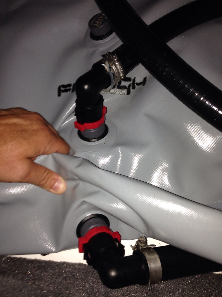

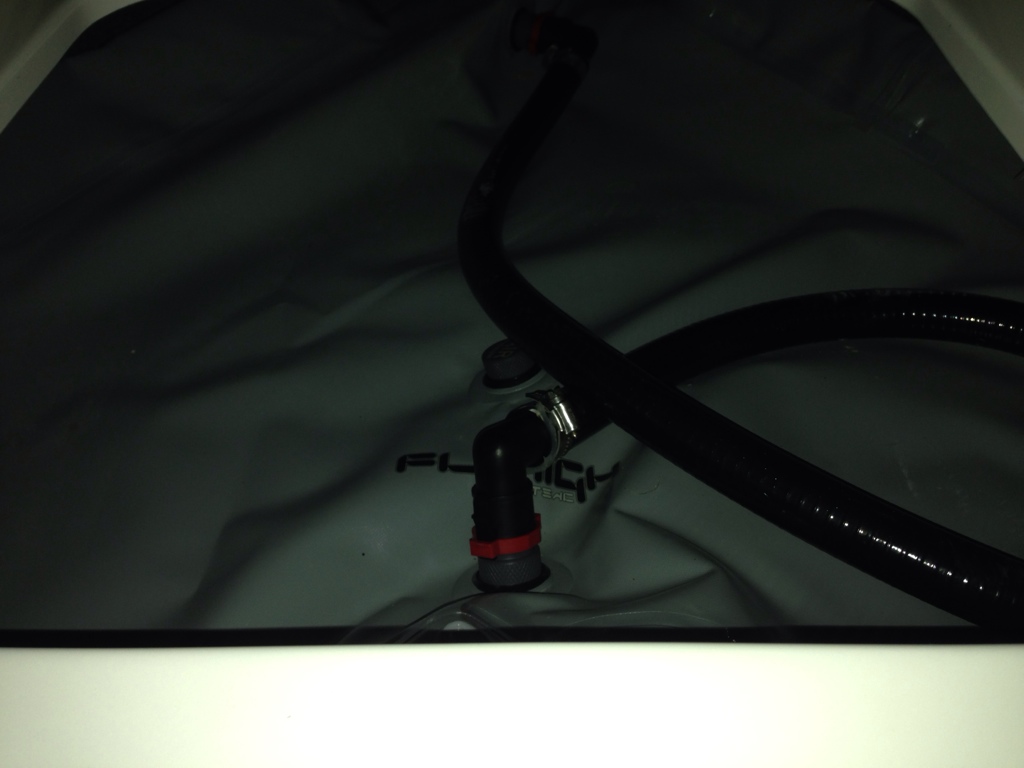

If I get a pic of mine, showing what direction each tube goes, would that be helpful? Let me know if so and I'll hop in there and take one..

the picture can be helpful,
do you need to reduce the length of an hose, when i lay down the bag, there is a plug on the right side and the hose that is suppose to go to this one is pretty long then ?
same for the rear bags with the draining
Not sure if this actually helps or not. Hopefully.
