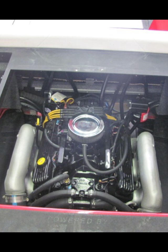

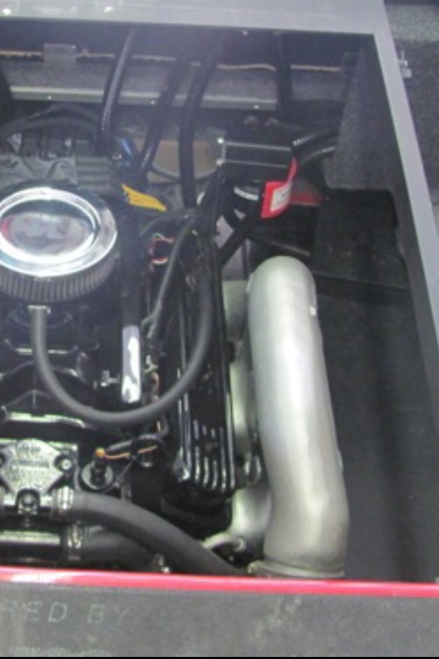

 Post subject: Re: How to tell if boat has a cat?
PostPosted: Tue Jul 15, 2014 10:39 pm
Here is a non cat manifold on my 2010

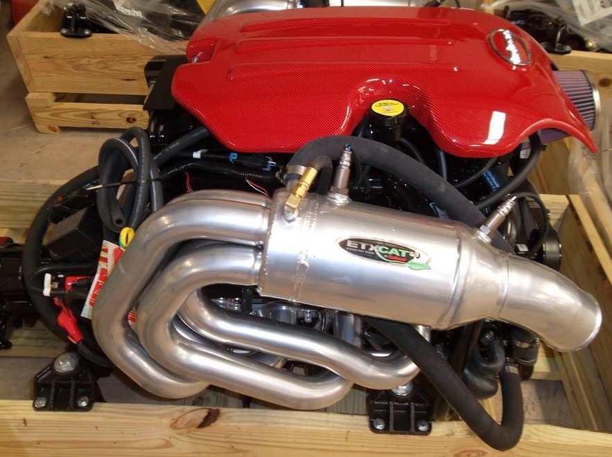

PostPosted: Tue Jul 15, 2014 10:49 pm
Non cat manifolds will probably be cast iron and have a textured feel on the surface, cat models will likely be cut out of stainless steel and have a large section 6-10" long where the catalyst will be installed and they usually have O2 sensors in the rear of the manifold by the hose connection similar to this pic
