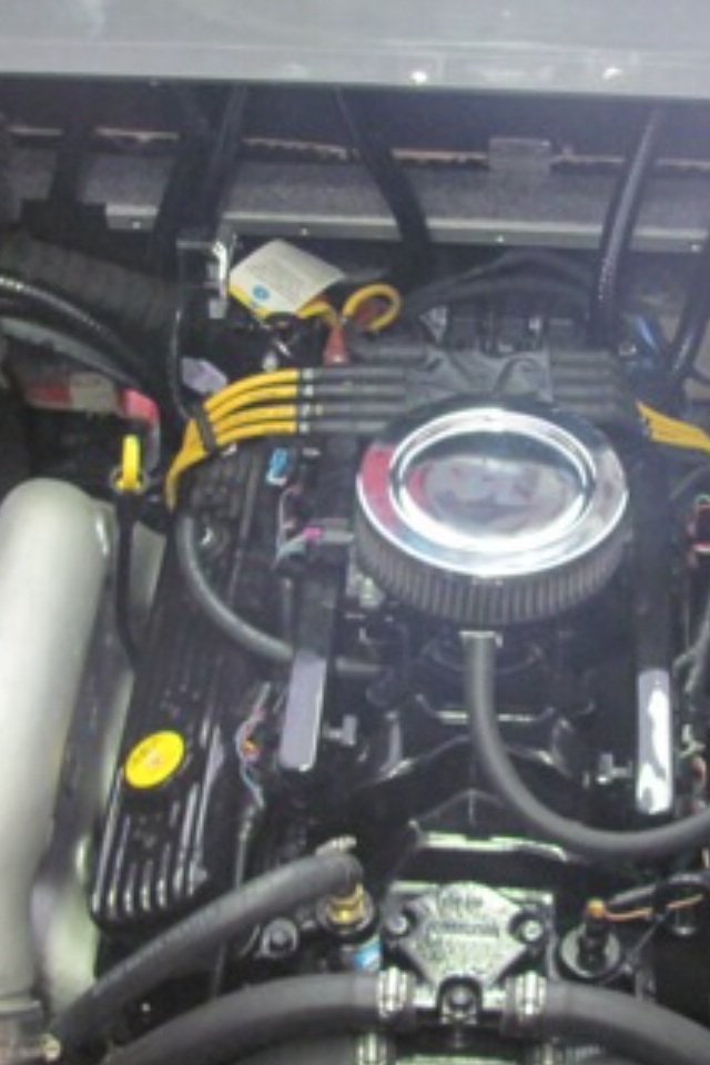

Hey guys,
I tried to dig via the search function on the forum topics but couldn't find anything helpful.
I have a 2010 A22 (non-salt series) and looking for a easy method to complete an oil change. Is there a drain plug somewhere? I have a electric pump but it worked 1 time and now it doesn't pump anymore (even with hot oil) and I want to avoid purchasing a new 50$ pump - I want to do it the oil way (drain plug) if possible.
Let me know :)
Mike

On my '13 there is drain hose. Its secured near the top of the engine.

Passenger side toward seat back is a 3/8 hose with a brass cap on it and it's clipped to the top bracket just behind the valve cover

At the top of this picture where the paper tags are is where it will be attached
It's a hose screwed into the drain plug hole in the pan, I'm not sure if it will reach the bilge drain hole or not but it's worth a try.

Hope your drain hose is longer than mine. The end of the hose on my boat daylights flush with the outside face of the thru-hull. Makes oil changes extra fun. I shouldn't complain though, with the oil at operating temp it drained in under an hour.
