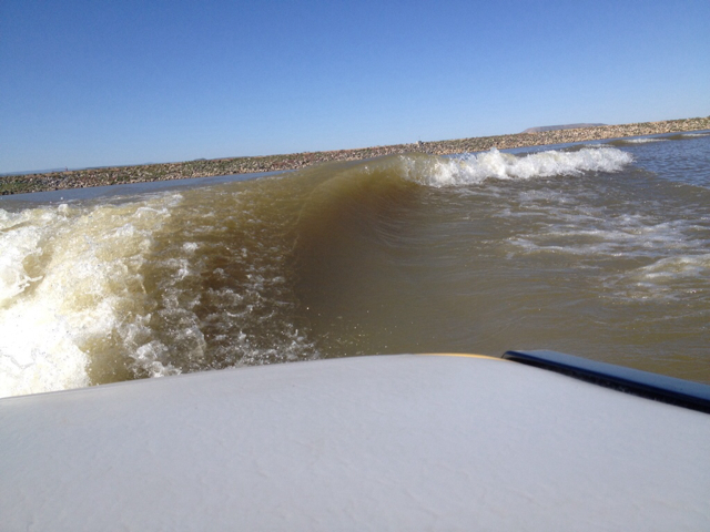

 Post subject: Re: Need help on how to add more ballast?
PostPosted: Sun Jun 22, 2014 10:04 pm
Posts: 67
Www.wickedwakesurf.com
I ordered one a couple weeks ago and now I don't have to get a new boat with surf gate. Makes all the difference in the world, even with the 2011 platform. Joe is great to work with!
