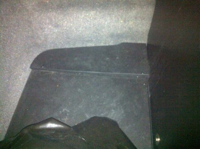

The drain pump should be in the far back under the plastic cover, just remove a couple of screws and pull off the cover, all the way back against the transom, the piece of the floor that's raised up just a little
 Post subject: Re: Rear pnp tank not draining
PostPosted: Sat Jul 12, 2014 6:41 am
Right here

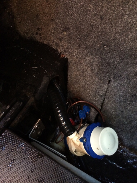

I pulled the drain hose off the pump and it's pushing water out. Put the hose back on no water coming out the side. So the hose must have a kink. I traced it from back of the tank but can't find how to see it under the floor.

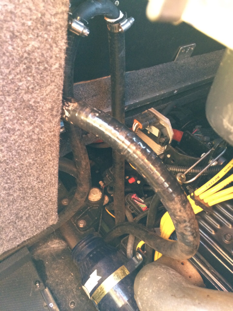

How can I tell if it's kinked between these points? It's not kinked anywhere past these.

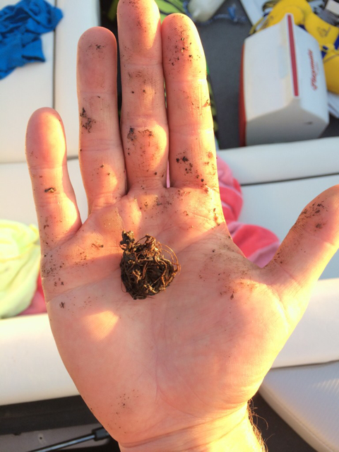

Ok found the culprit

Crazy how that didn't get tangled in the pump but stuck in the hose instead
