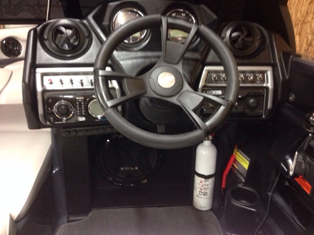

Just purchased 4 Exile SXT65q, ZLD, 6 in boats and the new XM 30.2 and XM 15.4. These are the new amps from exile that are suppose to run cooler for us guys in the more hot/humid areas. i will also be re-locating my sub to underneath my dash with a simple ported rhino lined box bolted down and a black plexiglass face plate. Cheap easy, looks ok and serves its purpose. i have a general knowledge on the install and feel comfortable doing it but wanted to see if anyone else who has a 2010 has done a tower install as i noticed there looks to be only one single hole drilled and one wire group per pair of speakers and then is just ran parallel from one speaker to the next. the exiles have the wire running through the clamp so aim guessing i will need to either run two more wires and drill holes in the tower? or is there currently another hole covered by a clamp and can i just splice the current wire without worrying about over heating the speaker wire? any knowledge or advice or experiences is greatly appreciated! i will post pictures as i go as this will be an ongoing winter project.

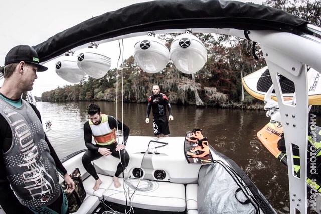

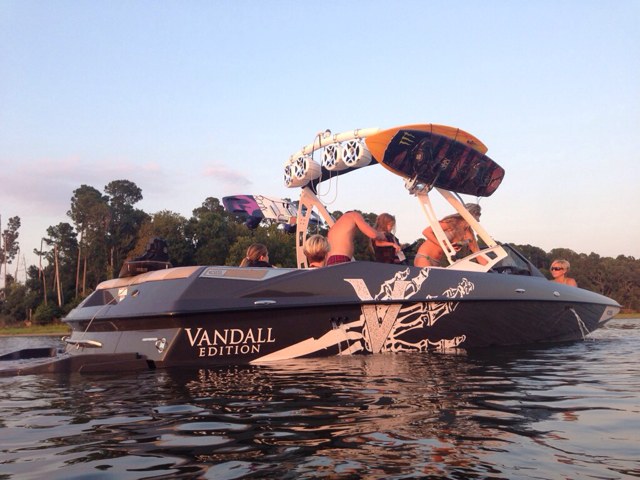

I love mine. Good choice

Texas boy the white is badass!! How'd u manage to pull that off?? I was planning on having the grilles and clamps painted but didn't know about the cans! That looks clean! Also do you have any idea about the 2010 tower and my wiring issue?
 Post subject: Re: 10' A22 Exile install
PostPosted: Tue Nov 26, 2013 6:48 pm
I think you can custom order them that way now. Check with whoever you purchased from.
As far as wiring goes jus use existing wires or string to pull new wire. Mine came pre wired and I just used old wire to pull the new.
