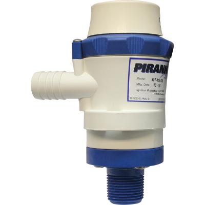

pump is located in the same location as your front drain plug( brass t-handle)
pump is:
Shurflo Piranha 800 GPH Aerator Ballast Pump
 Post subject: Re: Front Ballast Bag Pump Location
PostPosted: Tue Jul 02, 2013 12:24 pm
yup. screw open that 8" round access cover next to your driver seat. you will see your center and front pnp fill pumps next to your front drain T handle plug.
