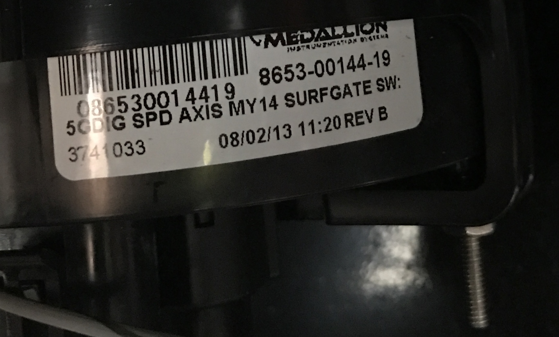

I'm having the same cruise control issue on a 2014 A20, attached is a picture of the tac label.
I called Malibu support and they said the tac issue was fixed on the 2013 models.
Rev B has the speed control issues. Lol. Good luck getting them to give you the right one. Hopefully it doesn't cost you to much out of pocket. Also, let me know if we can help.

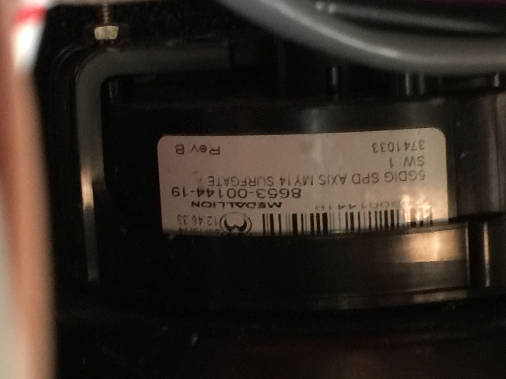

I'm having the speed control issues on my 2014 A20. Big surging, worst at surfing speeds.
I will check the gauge to see what the sticker says tomorrow.
I'm definitely out of warranty, but do you guys know if Malibu will make this one right on their end if I have Rev B?

Well, Malibu tells me this is the most current unit.
