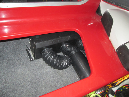

I also choose a pull tube in the breeze way
For my non pull out vent I choose the right side of boat instead of footwell
I relocated the weight tags to a diff location and mounted vent there. This was very hard. You need remove that black plastic cover after you cut 3 inch hole and make 3.5 in hole in fiberglass so the flex tube can mount and fit threw second hole since plastic isn't flush
Then attach to heater unit
Double check all functions before you but the boat back together

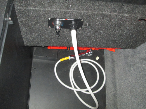

Shower Install. Going to mount the shower head next to the unit to get it up off of the floor and out of the way of the Ballast bags.

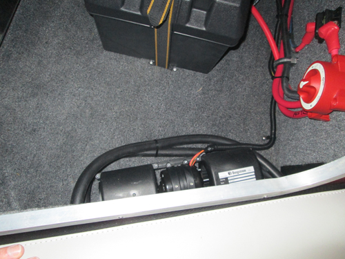

Heater install under the passenger seat.

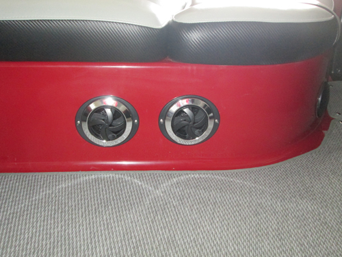

Vents.
