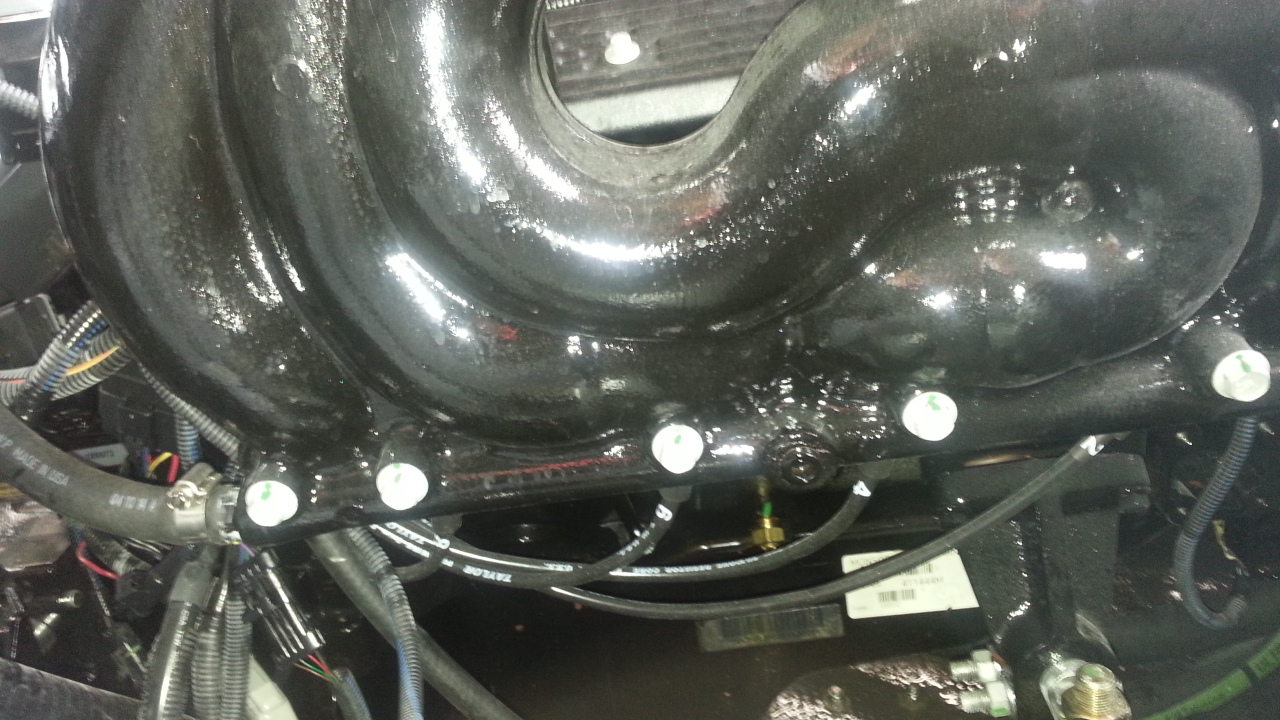

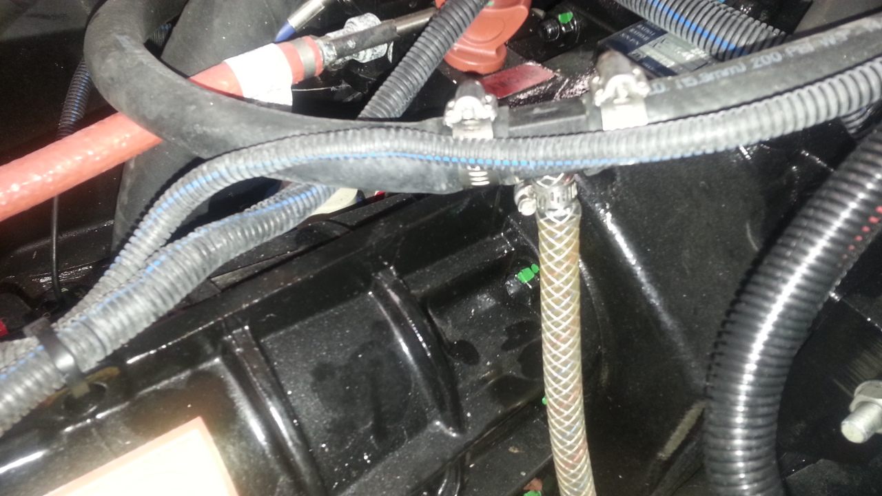

2014 T22 ... 5/8" garden hose connection, the only thing that I see is this. Looks like it connects to the dripless shaft connection. The hoses come off the exhaust manifold then T into a single smaller hose. There's no garden hose connector correct?

Whats the deal with the garden hose connector on the 2014 T22? Mine doesn't have one ... am I missing something?

I also do not have the connector, Just removed the clamp and drained at the T
Is it alright to just remove the knock sensors or do the plugs they bolt into also need to be removed?
