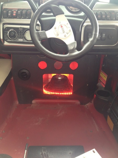

PostPosted: Fri Oct 18, 2013 2:01 pm
 Post subject: Re: Group Buy Heatercraft Heater / Shower
PostPosted: Fri Oct 18, 2013 4:33 pm
So is the return only connected to the water system via low idle Y or does it also reconnect to the water pump on the valve labeled from heater?
PostPosted: Fri Oct 18, 2013 5:26 pm
Yes. Although I have not tested in the water yet. From my understanding that's the way it's to be done. Maybe we should call heater craft and ask him.
He is very helpful. He walked me through how to wire the toggle switch. The instructions that were included were for a different type of switch.
