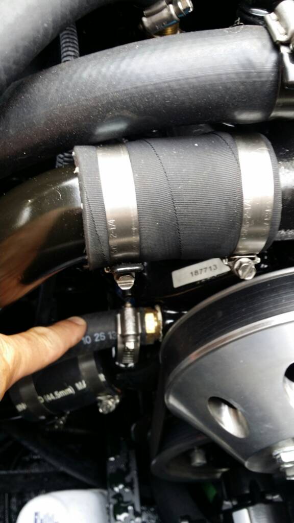

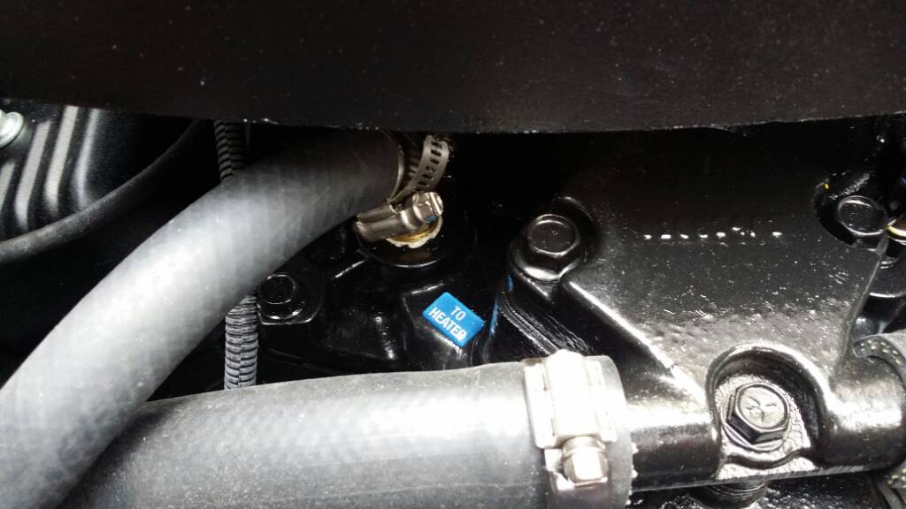

These are the 2 hoses I think are for the heater. I cracked the lower which I think is the return and got coolant out. I think I'm good to go. What do you guys say?

Ya those two hoses go to the heater core up under the dash
