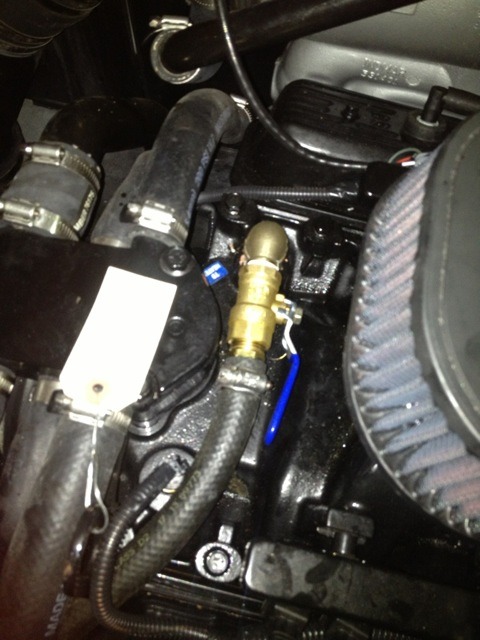

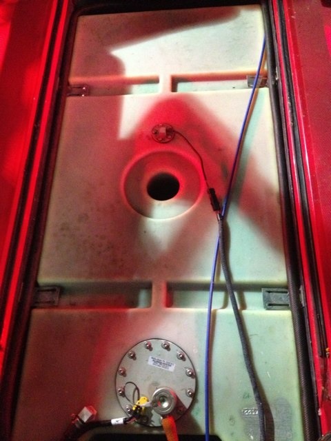

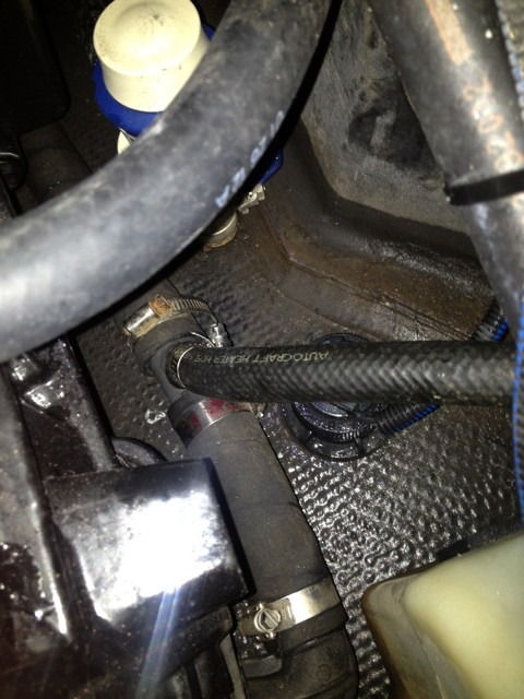

Ok here is the start of my install.
As you can see the hoses run along the gas tank real easy. I fed line to the heater on the right side.
The line from the heater on the left.
I put a shut off valve on the main line coming from the motor.
I connected the low idle "Y" to the left side of the tranny.
I mounted the heater in sub box compartment all the way to the back. ( this was a pain in the ass) get one of your friend that is small my big ass couldn't move around in that hole.
That's as far as I got last night. Took about 2 hours to run lines and mount heater. No wiring or vents run yet.

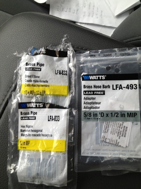

do you still have the p/n or size of you brass shut off valve and elbow? I was going to do the same thing but didn't know exact thread and pitch
 Post subject: Re: Group Buy Heatercraft Heater / Shower
PostPosted: Wed Oct 16, 2013 8:13 am
Hope this helps

Part number for ball valve ..... All p/n available at lowes home improvements
