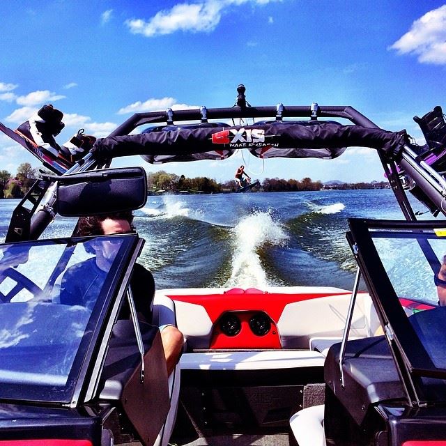

The 800s fit perfect. Didn't have to reinforce anything. I'm running both 800s full in the back, center tank full, nose bag (under seats) full and then an 800 Ronix sac in the nose (over seats). I also have about 500lbs in lead throughout the boat. So about 4000lbs of extra weight then people, fuel and gear. No Wedge. It planes off super quick and the wake is huge with a nice landing ramp. I like it better than my last 2 A22s. Especially since there is more room and there is more storage under the seats along with the ability to put a hard cooler (included) under the seat. I love the T22. Glad I switched!!

Here is a pic. It's from up high in the nose of the boat but, the wake is big!
