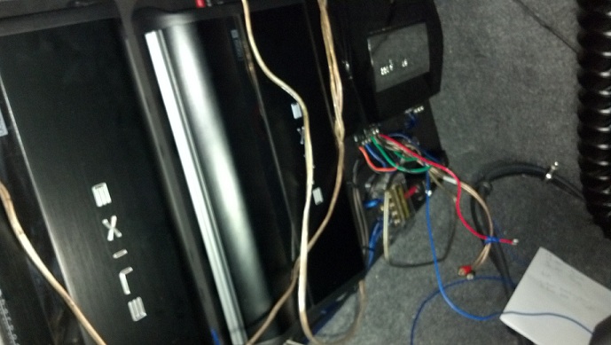

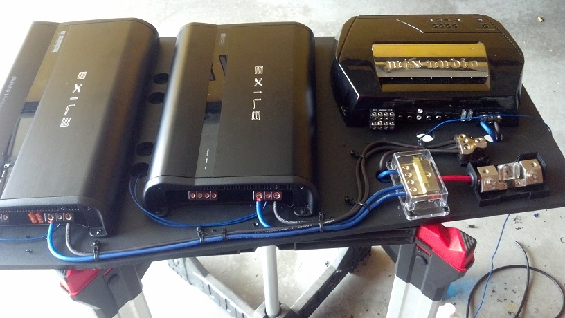

The install is progressing. Amps mounted on rack....check Power wire ran check... Rack back in the passanger locker...check Inboat speaker operation test....check Run new tower speaker wire, run sub speaker wire, install tower volume control, and install XM9s...In progress!
