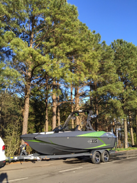

So the new 1.72:1 gear ratio with the 2313 prop is awesome. Took out the T23 and filled everything up. About 2,900lbs plus the wedge down and it planed off with out struggling at all. Wake looked huge, it was too cold to ride though. Pretty pumped on having more torque this year.

Good feedback! How were the rpms? I was told the 2313 will run only about 250-300 rpms higher than the 1235.

I honestly didn't pay attention because I hadn't downloaded a GPS app to set the speed right.

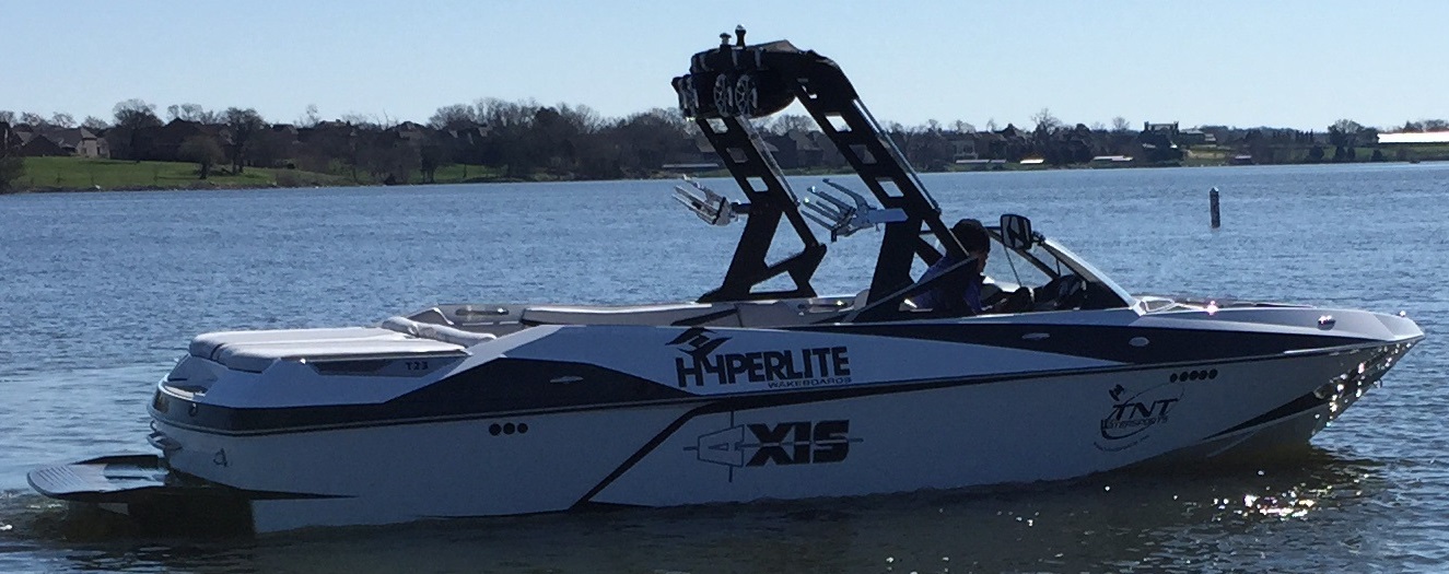

Ran the 2313 on my 350 2015 A22 yesterday. It has no issues planing, but it's too low of a pitch for me for regular use. I'm probably going to swap it for a 2249. Top speed on a 2313 is 31mph. 2249 should get me closer to 38mph.
Regardless, had a great day breaking it in and love the new changes to the 2015.

Do you still think the 2313 is the best option from the factory? And how much weight were you running?

if you want to load it down the 2313 will be great! if you want a more versatile boat, I think the 2249 will probably be the way to go.
