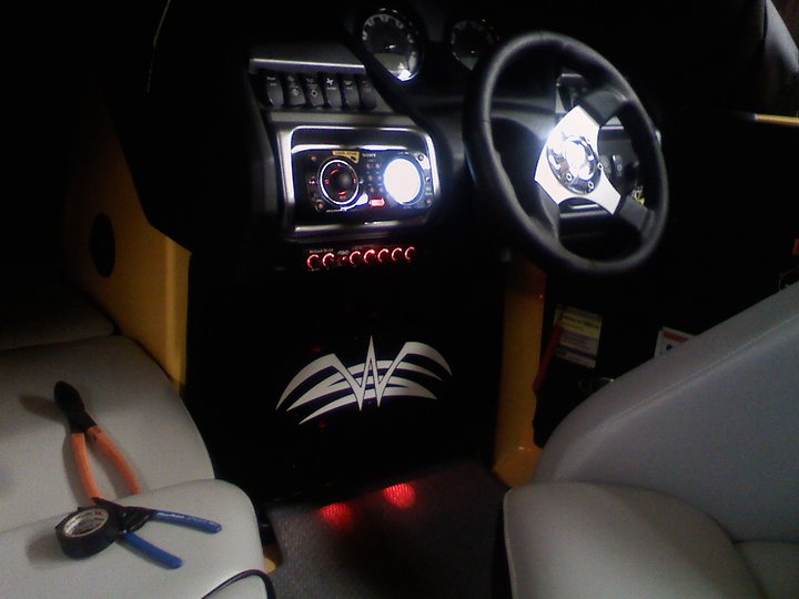

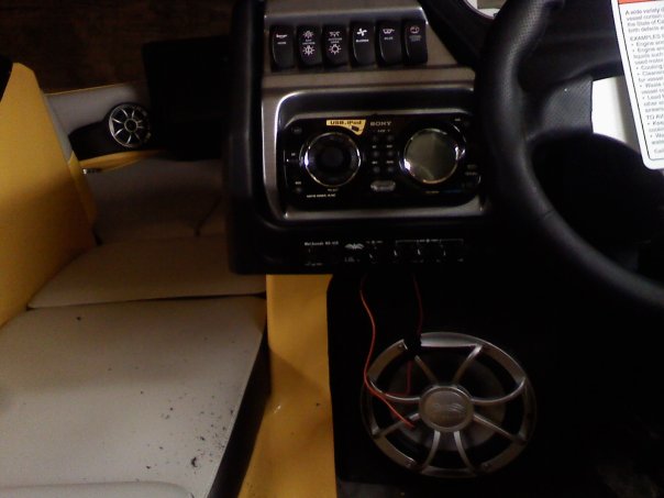

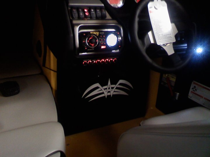

I put a WS-XS10 in a box powered by a syn micro. We pulled out the foot tub and put a plexi panel painted black in its place using the original screw holes. The Wetsounds logo is raised and acts a vent for the sub. It hits pretty good. No big rattling issues after 2 years. The heater tube rattles a little and the tower mirror shakes a little, nothin terrible.

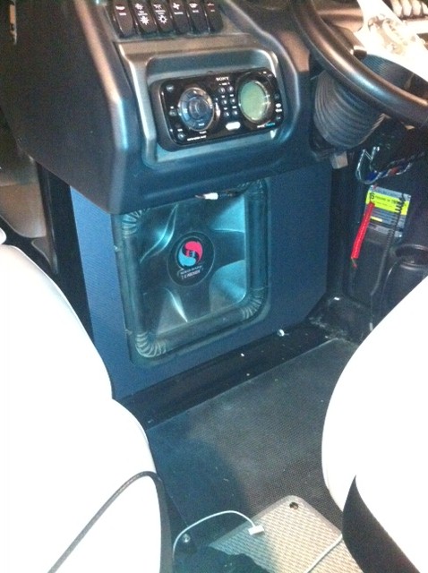

Finished my sub enclosure with the 15! Since it is an older S7, I only needed about 1.5 ft^3. With a crazy box that I didnt get any pics of, I managed to squeeze about 2.25 ft^3 and used Polyfill to fill the box. Then I cut out a piece of plexiglass to cover the hole and wrapped it to match the dash. Turned out great and sounds amazing!! Thanks for the advice guys!
