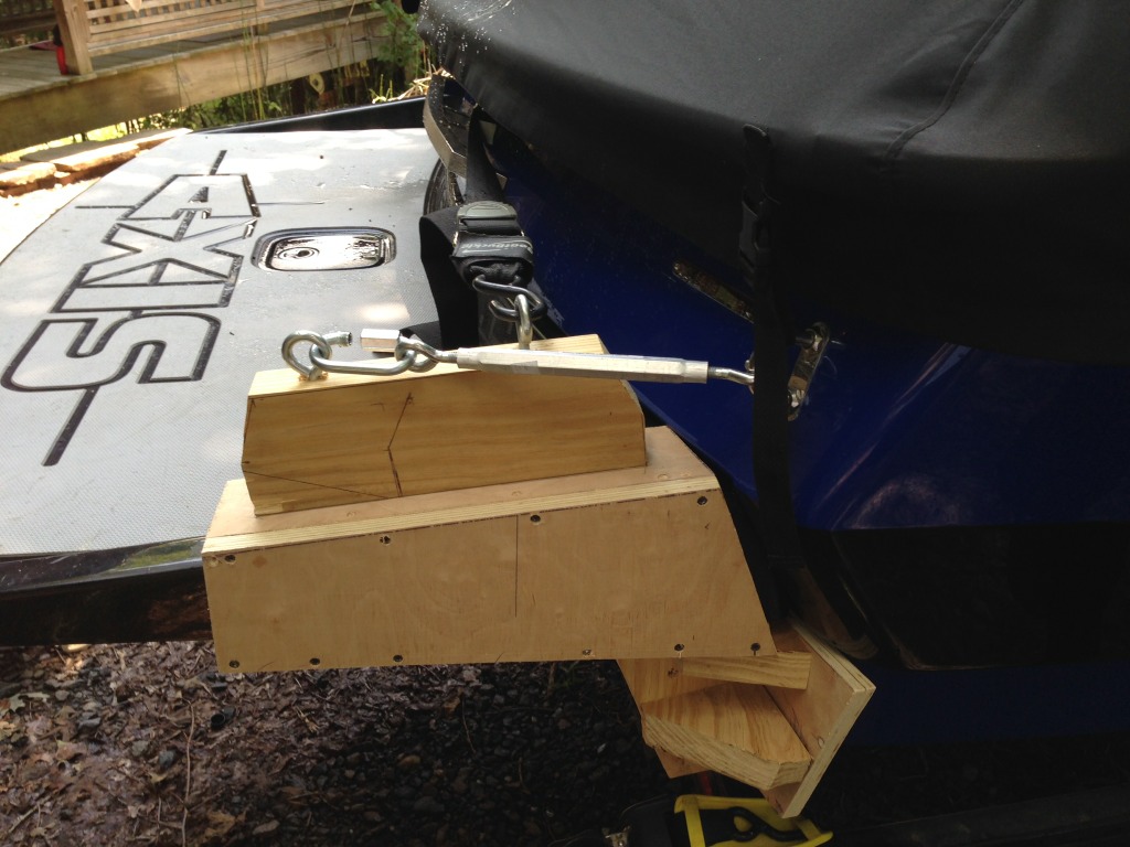

Well ....... Attachment failure..... Clamps no go..... So I have modified it again so I can use a turnbuckle and ratchet strap. However now that it is deff securely mounted I don't think it will work unless you have another ratchet under the platform. When I attach it and pull on it, it looks like its just going to twist the lower section off. Im willing to get in the water to attach the other ratchet but that option is not desirable if it's going to compete with the simplicity of wicked wave/ redneck gate. So I took you guys advice and trimmed it down, but not all the way down to NSS standards but now it only protrudes 2 inches from hull ...... I'm still doubt full that it will hold, I'm going to try it today with and without the under strap to see if it's worth moving forward or not.

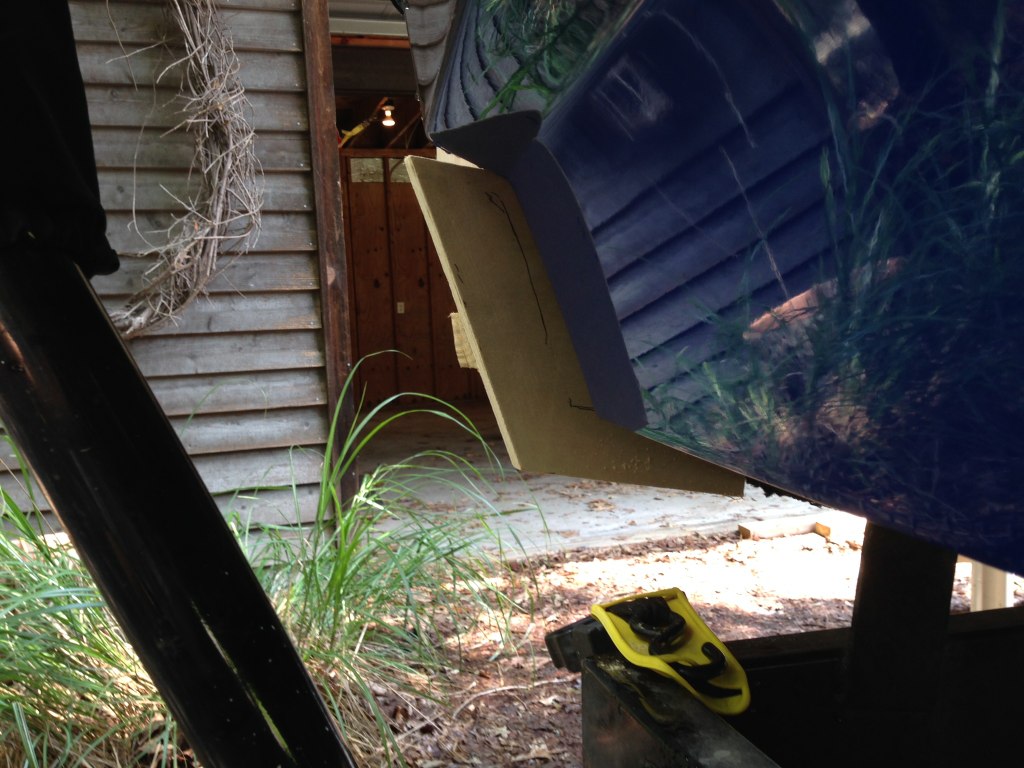

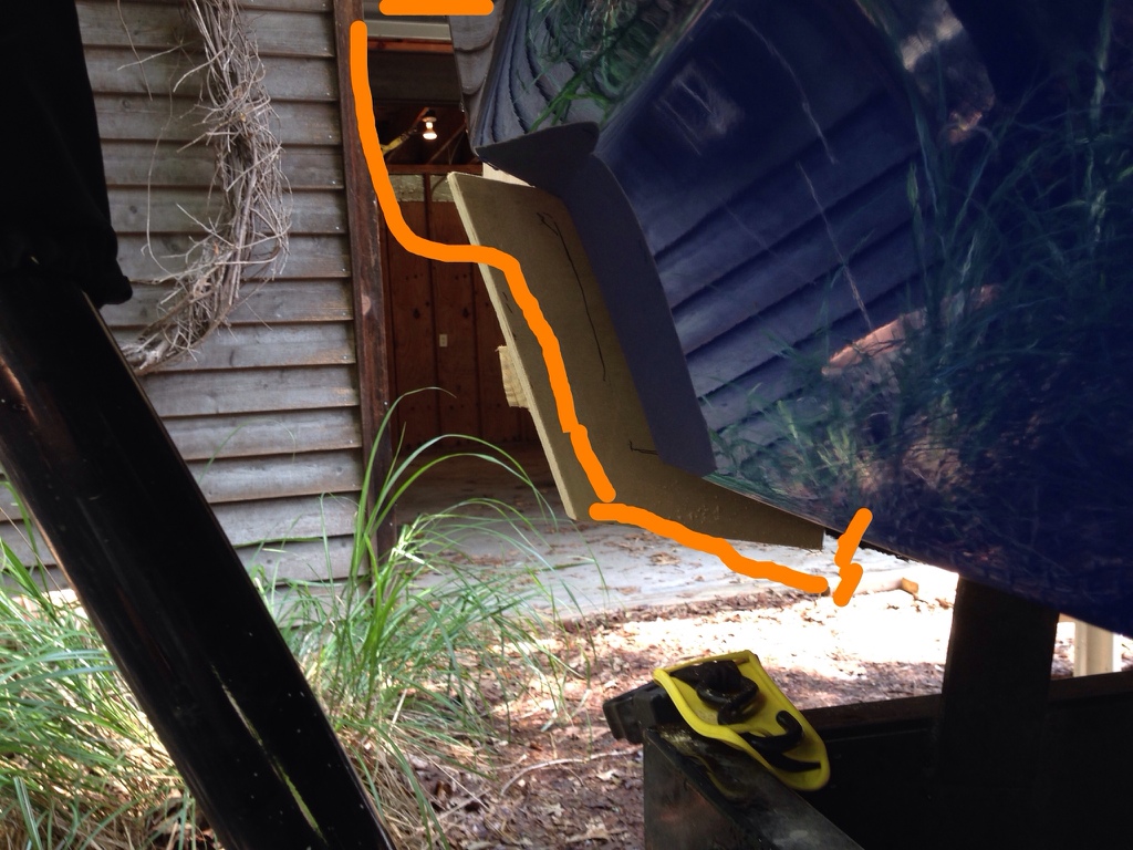

So you think it was to far in the water so there was to much coming over the top? And I should make the paddle go higher

Looking at this and some other DIY projects - http://features.boats.com/boat-content/ ... f-on-this/ - it doesn't seem that it is required to be very high. From another thread I think the user went about 2 inches out to the side, but only around 3/4 down from the bottom with his plate.
I think this might work better on boats with a flatter transom. I was thinking about cutting some foam to flatten out the area and then mounting the plat back where I have it shown in this image.

I do think morrisdl has a valid point. even fully sacked out the g's platform is on top of the water, which puts NSS at water line. mine depending on front ballast is usually 5 to 6 inches under water, which would explain why it worked better with no weight. its worth a shot its easy to modify the plate as long as I don't have to modify the mount. I wish I had a better understanding of exactly which part affects what part of the wave
