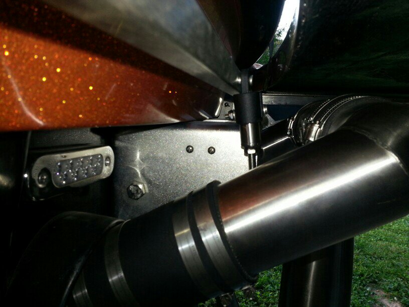

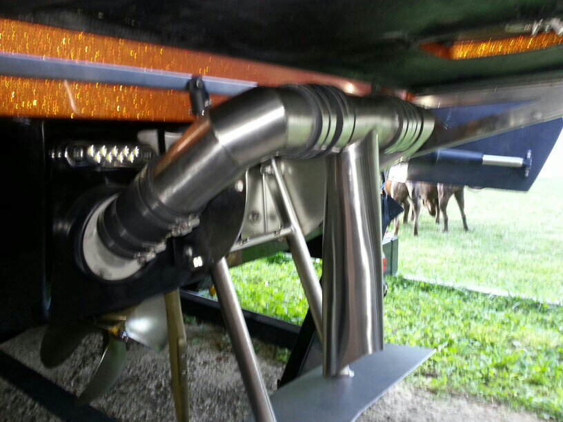

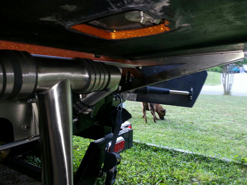

PostPosted: Wed Jun 04, 2014 6:17 pm
Finally finished up my install. I am not sure if this is how it goes, but it works. Mine probably took me 5 hours or so. I split it up between three days so some of time was spent getting tools out and running to home depot.
