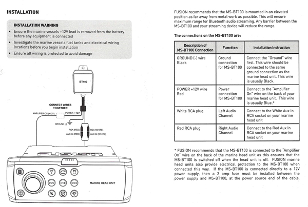

Anyone got any pics of instalation?
I would love to do this also!!
I am running the Sony head unit from factory.
Black wire from Bluetooth to black wire. (Ground)
Red wire from Bluetooth to Blue wire from head unit. (Power)
Plug the two RCA jacks to the AUX jacks from head unit and you are done.
Hope this helps.
