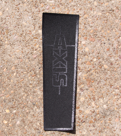

Wow. I was told that it would be some kind of decal with Axis cut-out or something a little more appealing to the eye. That looks just like a pieces of solid black deck trac..? Please tell me I am wrong?

Here is the fix that Axis has done for the corners. Picked mine up today along with seat skins.
Thinking about taking a razor and cutting out the Axis to give it a little better look in the corner.

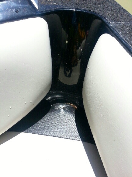

We had the same thing, I was lucky enough to get a picture as it was happening. As you can see, it can concentrate the light from the very top edge. So I'm not sure the sticker on the flat vertical section will stop it. We had ours fixed also, no questions asked, and opted for a light grey insert, and it has been fine since, but Keep an eye on it guys, as ours got to the point where it was so hot, it was smoking, and nearly caught alight.
2012 Axis A20 Down Under
