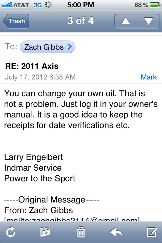

otownwake wrote:
Don't you have to let the a certified Axis dealer do the maintenance in order to satisfy the Indmar warranty?
don't think so

 Post subject: Re: Oil Change
PostPosted: Wed Jul 18, 2012 5:38 am
I emailed Indmar about the warranty when doing your own oil change.

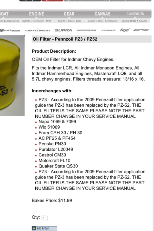

PostPosted: Thu Jul 19, 2012 8:37 am
Posts: 276
Diggertaker wrote:
Oil filter is a penzoil pz52. If it cant be purchased at the auto parts store have them cross reference it in another brand. The oil drain cap is attached at the front of the engine on the right if you are looking at it from inside the boat. It is a black rubber tube with a key ring type attachment secured to the cap. It is attached through the key ring to a bracket to hold it up. Once you get the key ring off the bracket you may need to use 2 wrenches to unscrew it since it is kinda tight from the factory. I'll try to attached a link to a pic of it. Copy and paste this link to the moomba forum. First 3 pics will give you an idea of what it looks like. FYI. You can also suck the oil out through the dipstick tube.
http://www.moomba.com/msgboard/showthre ... pics-by-Al
Here's a list of compatible replacements for the filter. Much cheaper at an autoparts store than bakes online.
