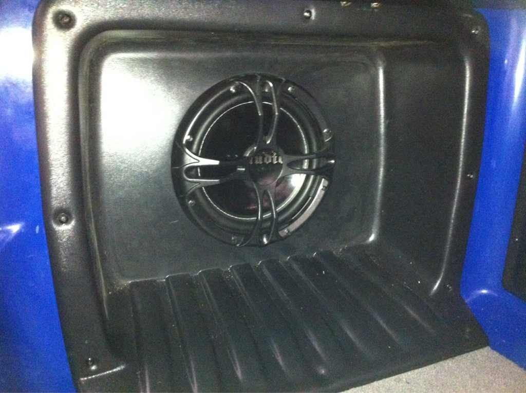

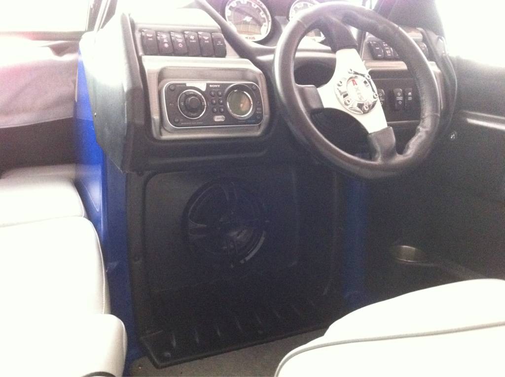

I did the same w the 2012 sub footwell. I moved mine from the dry storage area and built a closed box to the appropriate specs for internal cubic feet and placed it under the dash. It made a huge difference and it's only a 10" sub. I liked the extra bass so much that I picked up a more powerful 10" sub (and amp) and put it back in the original box in the dry storage.
