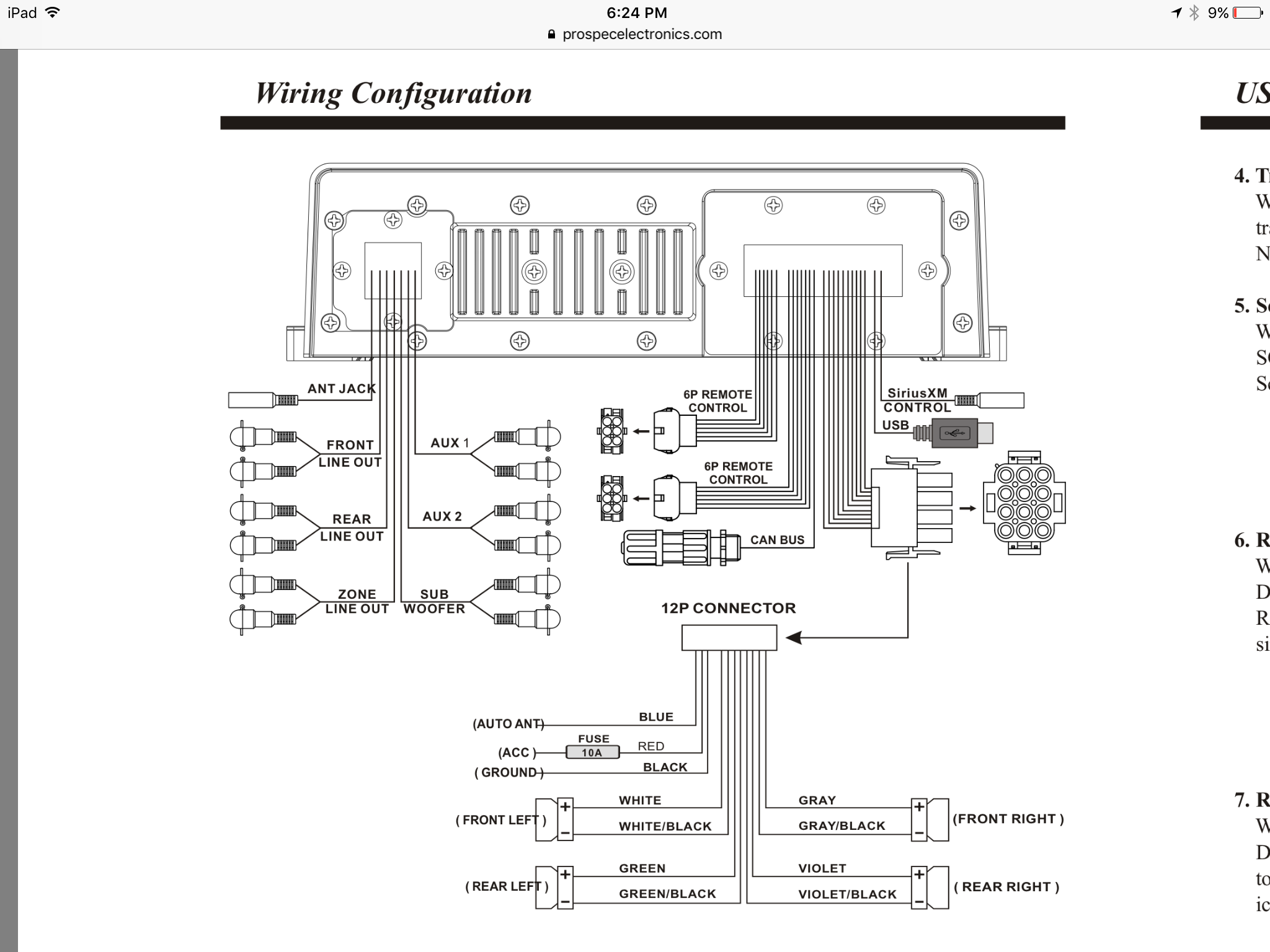

Any idea which wire in this diagram is the remote wire for turning the amps on?
Blue wire (auto ant)
