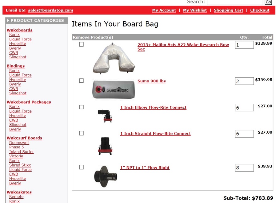

About to send the order in today. :D

My order has arrived and I am going to install the bags this weekend and I am planning on trying them out on Sunday. I am not 100% sure yet how to install the vent lines from the hard tanks. I have looked across the forum but haven't been able to find clear instructions. I am sure I could figure it out if I spent some time to look at it. But, I might wait to tackle this a little bit later.
I assume there is a vent on the hard tank on each side of the boat right? So I would just take the vent from the hard tank and plumb it to the extra top port of each bag? Honestly, I am not even sure how to access the hard tank, but then again I have never tried. Do you need any additional tubing/hardware to run the vent to the top of the bags? And how do you re-route it?
What about the front bag, I assume this doesn't need a vent, right?
Sorry for all of the questions.

I Y-ed my bag vent into the hard tank vent... much easier.
Front bag needs vented.

Search my threads, I posted pics and what's needed to y into rear hard tank vents.
Front bag should have came standard with a vent line so you just hook up all 3 lines to bag.
