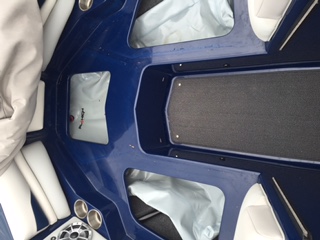

Here's some pictures of the center and bow ballast set up just so it's all in one place.
File comment: This is the fly high PNP bag for the A22. I'm not sure what weight is advertised but my best guess is a 650 that fills to about 500. It has a fill and a vent at the nose. As well as 2 drains, one down each leg. The bag lays the best as far forward as possible. You can pull the rear drains out a little to give more room. Just watch out for the bow eye bolts on the inside. I covered mine with some foam just to be safe.

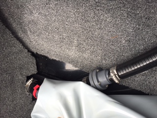

File comment: This is the port side rear of the bag. It has a drain at the bottom and a fill with a check valve that runs up to the front of the bow

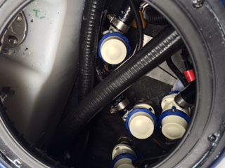

These are all the pumps located under the center access hatch. You can see the center tank at the top of the picture. The furthest left pump is the bow fill. Closest to that is the center fill. The bottom most pump is the bow drain and the furthest right is the center tank drain. All pumps are 1100GPH. All fill pumps have a shut off valve attached to them. Hopefully this helps someone out with the 2016's. I'll update how the vents work this week once I get on the water.

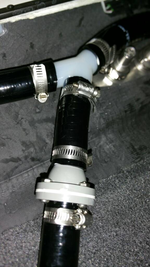

Nice write up, I did this exact setup a few weeks ago except I put the Y fittings a couple feet or less from the through holes, you are right that when your draining you will be circulating water until your empty so before I went out again I added wakemakers in line check valves between the Y and the sac to prevent the circulating and it sped up the drain time quit a bit. I have a 2016 A20.

Good idea Steve. I was concerned with there being a vacuum if somehow the draining caused a Venturi effect on the vent line. I'm glad to hear yours is working good for you. I'll keep those check valves in mind if I have any issues.

Here's a pic, I added the valves close to the Y, zero issues!
