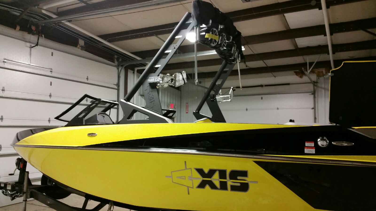

For some reason it has the 2015 tower on it even though it's a 2016 boat? Does anyone know if the quick clip disconnects can be installed instead of the knobs? Can see those ending up in the bottom of the lake by the dock?
I'll try and post pictures from my phone (it's yellow and black)

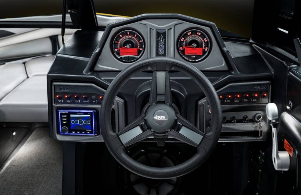

2016 Dash
[attachment=0]Screenshot_2016-03-27-13-20-43-1.png[/attachment

Looks like they just tap more holes for a Malibu tower clip. I'm not sure if thier on everyone or if they only do it on quick release ordered boats, I ordered mine with sorry I don't have a better picture
Wow is that a t22?
If so That's my exact boat lol!!
Yeah I reached out to the dealer, he is looking into seeing if they can add them. Hopefully it's a simple task!
