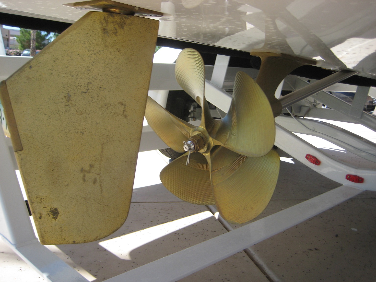

Can you post some pictures of the rudder and fiberglass around the rudder?

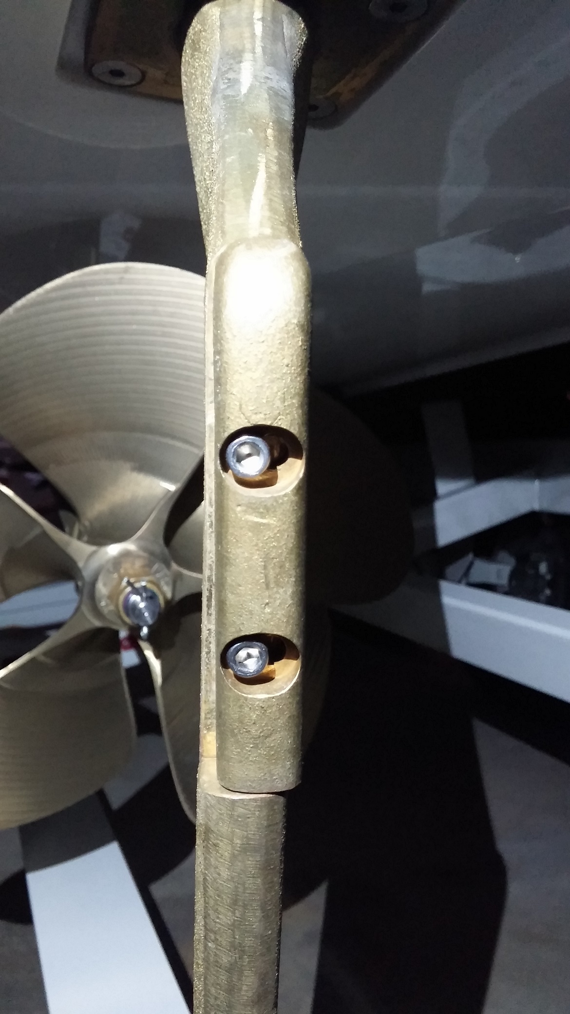

Heres some pics I already had on file.
Pic of the rudder tab is show how far it will go. I thought about making the holes longer so they could adjust further. Any ideas?

If the wheel rotates freely out of water easily both ways, then I would look at your prop. It doesn't appear like your rudder has had previous damage.

I do have future plans to get the 2315 prop, but wasnt really going to do it anytime soon. I just cant wrap my mind around it being the prop, or even the steering cable, just because everything is great until you try turning left. Im going to try to make the holes longer on the rudder adjustment and see if that improves it. I dropped the rudder and the rudder turns freely with no noticeable slack in the seal/housing. I put some grease on the rudder, but then found out that was a no-no. The axis rudder boxes are not serviceable and use water for lubrication. I was told to wipe the grease off otherwise it may lock up. So with that advice I plan on dropping the rudder again and wiping it off.
