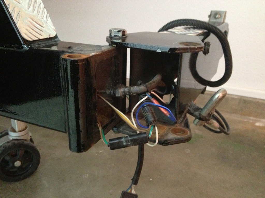

I found out why mine would randomly not work

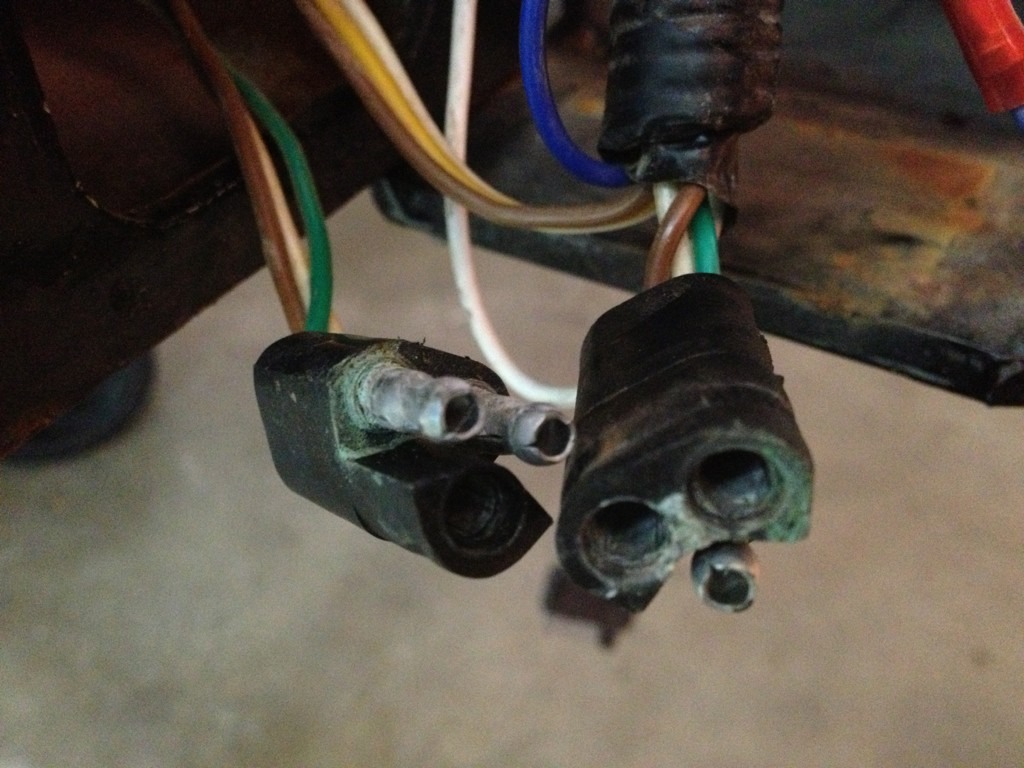

This connector had a little bit of oxidation around the terminals, I just cut them out and heat shrinked them with butt connectors
To fix your runway lights take out the left rear tail light and check the connector on the brown wire, it's not waterproof and can get corroded over time, clean it up and tape it good and that should fix it, I just hooked my runway lights up to burn all the time
