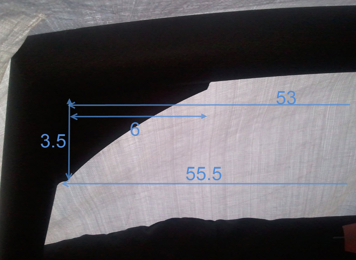

Does anyone have access to their boat where they could get me a measurement of the cross bar at the top of the tower where you'd mount speakers? I am trying to plan out what I need for my system and it'd be a huge help to see how much space I have to work with up there. I also posted a different thread, but if someone could see if the wetsounds 808s would fit in the stock locations in the interior it'd be awesome. They are 8.89" overall. Im just worried about how tight it'd be in the bow! Thanks in advance

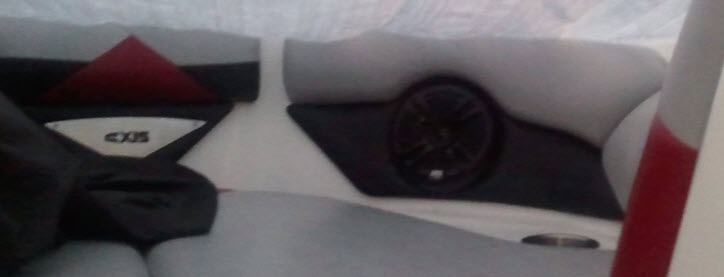

These dimensions are from an 09 and I'm not sure if the bow has changed enough to allow for larger speakers. In my case the speakers are 7".
The tower has 53" of space inside, but less for mounting due to the corner supports. When you drop below the corner tabs it increases to 55.5". The 3.5" dimension is measured vertically. The corner supports are 6".

Thanks a lot for the pics. I was hoping 2 pairs rev 10s and a 410 in the middle would fit but it won't :(

On the 808's you probably can get them to work, but you would need to cut the cushion panels and then reattach the vinyl. Have you considered keeping the 6 1/2 and adding the 808's on the floorboard panel?
